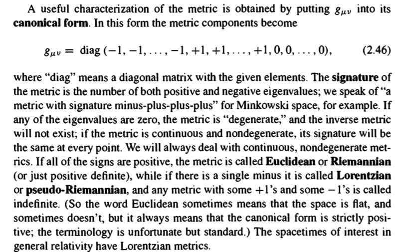

Sorry, I should have been more specific. I'm using Carroll's definition from An Introduction to General Relativity. I'm not sure what a good way to do this is so I will just post images of the relevant pages (pg. 73-74)
Above is his discussion of what "canonical form" means.

If you mean "pick a local inertial chart so that the metric takes its Minkowski form at your chosen point", then there could be one minus or three minuses in the signature, depending on your choice of signature convention.
Later he goes on to describe putting the metric into canonical form, which seems to agree with what you said here (with specific choice of one negative and three positive in the signature)
PeterDonis said:
If you are taking the Schwarzschild metric in Schwarzschild coordinates to be an example of "canonical form"
So using this definition, no, I should not have associated the Schwarzschild metric with the "canonical form".

then you have to add to your specification that it does not matter which coordinate is the "odd one out" (the one whose signature sign is different from the other three). As long as one is, the metric is Lorentzian.
Although in Carroll's definition, it does not seem to matter which coordinate is the negative one in the signature when the metric is in "canonical form" for the signature to be characterized as Lorentzian. However, in our specific case, he does seem to imply that when we put the metric into "canonical form" locally, we can make it specifically Minkowski to zeroth order and have the first derivative vanish.

Ok, that corresponds to the first option I described, choosing a local inertial chart so the metric is in Minkowski form at a chosen point.
Correct.

In Carroll's definition, it does not seem to matter which coordinate is the negative one in the signature when the metric is in "canonical form" for the signature to be characterized as Lorentzian.
More precisely, it doesn't matter whether you choose one positive and three negative, or one negative and three positive. Which of these you choose is usually called a choice of "signature convention" in the literature; the "one positive and three negative" choice is called the "timelike signature convention", and the "one negative and three positive" choice is called the "spacelike signature convention". This choice makes no difference to the physics.
Yes. The technical name for this choice of coordinates in the literature is "Riemann normal coordinates"; another common name is "local inertial coordinates".
