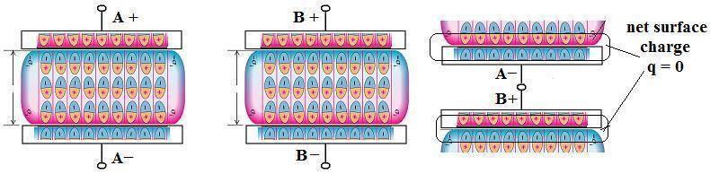

Suppose you have two capacitors, each with the same capacitance. Let's say, 1 farad each.
You apply 5 Volts to each capacitor individually, thus having them store 5 Coulombs of charge each. (Charge / Capacitance = Voltage).
From my best understanding of charge storage on capacitors, (based on wikipedia), 5 coulombs of charge is on one plate the capacitor and -5 coulombs of charge is on the other plate. This applies for both of the capacitors.
To make the explanation easier, label the first capacitor's positive plate A+, its negative plate A-. Label the second capacitor's positive plate B+, its negative plate B-.
If I connect A- and B+ to my precise voltmeter, I get 0 V.
While the voltmeter is connected, if I connect A+ to B-, then I get 10 V on my voltmeter.
In classical terms of electromagnetics, this makes perfect sense. By connecting A+ and B-, the two capacitors are essentially in series, both with +5 V. Thus you get +10 V on the voltmeter.

If you have the two isolated capacitors, and connect A- to B+ with a very low resistance wire, apparently (as far as I was able to tell) there is absolutely no charge transfer between the two points. Let me restate this: There is 5 Coulombs on one end of a wire and -5 Coulombs on the other end of the wire and there is no movement at all of these charges.
If the two charges were isolated from the capacitors and connected by the wire, they would neutralize.. probably with a loud bang because 5 Coulombs is a lot of charge.

You may not be able to measure it but the PD between the + plate of one capacitor and the - plate of the other should be (is) 5V, if they were charged on the same device and held in perfectly insulating mounts. It is hard to measure because the capacity between them is so low. As they become more and more 'connected' that voltage will become 10V because they will float above and below the mean potential of the two joined terminals.
I think that the following is the 'nub' of the problem:-
Why should the middle capacitor 'gain charge' as you say? All the surplus electrons on the negative side of the 'top' capacitor are crowding on the - plate and all the 'holes' on the + plate of the lower one are on the lower plate. They are very strongly attracted to each other. There just isn't much charge 'outside' the devices because the charges are all held inside.
This is a bit like the fact that all the charges on a Van der Graaf generator ball or Faraday Cage are on the outside and none on the inside.
When you insert your third capacitor, you are just doing the equivalent of my bringing the backs of the plates together - the small Q and the C(added) will produce only a tiny V. The net charge of the two plates which were joined together will be zero.
Do you not have an electronic voltmeter? Their input impedance is very high and you appear to be using fairly beefy capacitors. But I guess the effective capacity between the two devices is only in the region of a very few pF to start with. Simply putting a high value C in parallel with this capacity will reduce, rather than increase, the voltage between them.
When you actually put a capacitor in circuit, the situation will change because the charges can flow away from between its plates. In this case, the other plate of each capacitor is undisturbed and still charged.

When you go back to the first chapter of electrostatics you probably seen the experiment with a charged glass rod or some other insulating charged material held close to a thin conducting sheet. You probably easily accepted that when say the rod was -ve charged that the conductor surface facing the rod had a +ve charge inducted on it and therefore the surface away from the rod became -ve charged.
But now have a new and more in depth look at this. Just look at the conducting sheet on its own. Here we have (I think) the situation you are asking for because:
1 Although the opposite charges are sitting very close opposite each other they are not moving at all towards each other.
2 Since we are dealing with a conductor the voltage difference between every point on this conductor must be zero.
3 There is no electric field inside the conductor.
So what’s going on? Why do the -ve charges stay put? You could perhaps claim there’s a repulsive coulomb force between rod and electrons? But that’s not possible because the coulomb force field cannot exist inside a conductor.
The answer is that the field of a charge must always end somewhere on an opposite charge. If there are no objects anywhere nearby we just say that they end somewhere far away. And that solves the problem because here the electrons on the sheet are now being pulled by a field going off in the distance. And this field is generated by the –ve charges on the rod and the far away +ve charges.
The sheet only “used up” some field, meaning that where the sheet is there’s now no field.
Since there’s energy associated with this field it must mean that the sheet used up some energy. This energy is used up in 2 ways. First there must have been a current separating the charges and since the sheet has electrical resistance some power is consumed. Second there was a small pull on the sheet which was converted to heat when the moving sheet came to a stop. Both ways energy ends up being converted to heating up of the sheet.

I suspect there is no closed path for charge to flow when the wire is coupled. A KVL loop should also show zero voltage drop around any open or closed circuit path in space. A sketch should help clarify the theoretical study.
The net charge at the surface of each plate contains two components.
A surface charge is induced on the metal conductors, which can't support an internal electric field.
A surface charge is induced in the dielectric right up against the metal conductors. But charge does not cross the metal/dielectric boundary.
The + and - charge is due to action at a small distance across the boundary.
The dipoles in the dielectric are like tiny compass needles fixed in space but able to rotate inside an electric field. They wiggle in the presence of an alternating current, so the device can pass AC, but they line up on the metal surfaces in the presence of a direct current source. After the source is removed, an ideal capacitor holds its charged state.
I'm fairly certain the voltage between two nodes must count the net charge on the plate and just inside the dielctric. I think this explains your voltmeter measurements but have not thought it all the way through.

SystemTheory,
I really like your attached picture. May I ask you where you got this illustration? It shows the pretty well the dielectric polarity that I have over looked. I originally ignored the dielectric because I thought that modern capacitors are mainly influenced by the area and distance between the two plates - that the dielectric is so thin, most of the charge is stored in the plates. Apparently I was wrong. Indeed, over the past few days I have been teaching myself a bit more about dielectric fields.
Thank you everyone for responding,
LiteHacker

Please note my analysis showing q = 0 in the figure at post #16 is incorrect. The charge in the dielectric at a plate surface is always smaller than the opposite charge on the metal plate.
Please refer to these two references and/or a good physics/electrostatics textbook for proper analysis:
http://www.physics.sjsu.edu/becker/physics51/capacitors.htm
http://www.ac.wwu.edu/~vawter/PhysicsNet/Topics/Capacitors/ParallCap.html
The edit button does not appear at post #16 so I am unable to note the error there.
