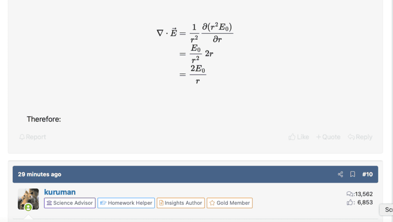

prosteve037 said:
Therefore:
Please don't leave us with a cliffhanger. Therefore what?
Likes MatinSAR
Not sure if my browser is at fault, but the LaTex should be there in the post. I did just edit my response; maybe it was a syncing issue 🤔 In any case, the "Therefore" is:
\begin{align} \nonumber
\frac{\rho}{\varepsilon_{0}} & = \frac{2E_{0}}{r} \\ \nonumber
\rho & = \frac{2 \varepsilon_{0} E_{0}}{r} \nonumber
\end{align}
Likes Cutter Ketch and kuruman
Whatever it was, it's fixed now in post #9. Good job!
Likes prosteve037
\end{align}
Actually, the cliffhanger is there when I first load the page by entering the thread (see screenshot below) and disappears when I reload. Oh, well.
  • Skeptical
Likes prosteve037
Weird. Same thing happened here.
