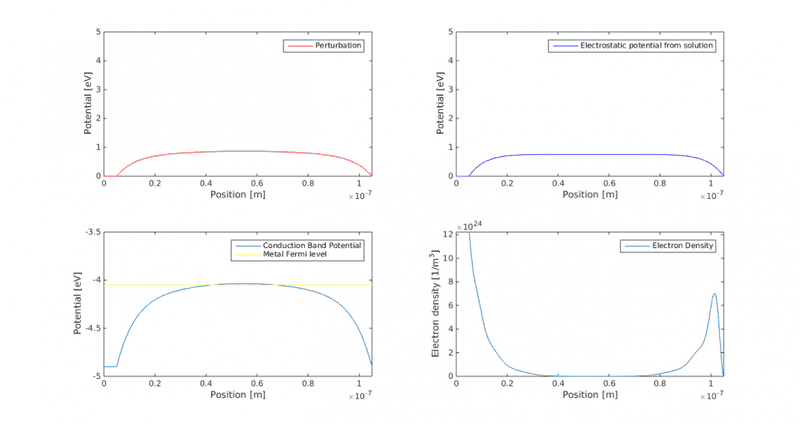

Okay might as well get the full story. My system considers a box with a semiconductor coated by a thin metallic layer. The semiconductor is much longer in the x- and y-direction than the z-direction such that we only considers electrostatic effects in this direction.
Now the metal sets the Fermi level in the heterostructure and determines the number of states that are filled up in the conduction band of the semiconductor. The electron density in the z-direction obeys:
ρ(z) ∝ ∑nklψ(z)l2
And inside the semiconductor I solve the Schrödinger equation:
2/2m* d2ψ/dz2 - eφ(z)ψ(z) = Eψ(z)
Here φ(z) is the electrostatic potential from the charge distribution ρ(z), which can be found by inverting Poissons equation ∇2 = -ρ/ε
The problem is solved and reiterated until a self-consistent solution is found. I should also note that the effect of the metal is of course that it screens the potential in the semiconductor. Therefore I have placed image charges inside the metal, which I use when I calculate the potential.
Now my question was to get an intuition on how the solutions should look like. Right now I get that the electrons migrate to the sides of the junction as shown on the attached picture, which shows an example of a self consistent solution. I guess that makes sense in terms of what you'd expect classically (charges flow to the surface), but I guess I wanted to do a proper calculation with the boundary condition that the charge densities must still vanish at the boundary to vacuum, which is clear from the expression for ρ(z) (now this is not true at the boundary to the metal, where the density explodes, but I chose to ignore that and look at the simpler, classical problem).

Interesting enterprise ! So you mix QM on a 100 nm scale with a continuous charge distribution that follows from the calculated wave functions. That does avoid the singularities from two electrons in one place, but if it's representative is questionable. And I really have no idea either.
