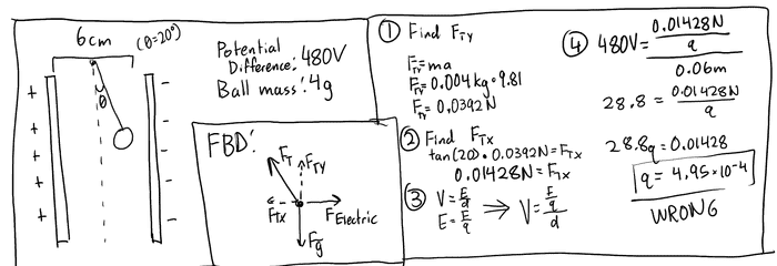

In summary, the question asks to determine the charge on a pith ball given the mass of 40 grams, the applied potential difference of 480 V, and a plate separation of 6 cm. The attempt at a solution involved using the equations F=ma, E=F/q, and V=E/d, but the resulting answer was incorrect. The correct answer is 1.8x10^-8, and the error may have been due to using milligrams instead of grams for the mass.

F=ma
E=F/q
V=E/d
This is my work shown to the end, although the answer is wrong I'm not sure what I missed, and any help would be greatly appreciated. The answer is supposed to be 1.8x10^-8, but I'm not sure how to get there.
http://imgur.com/a/sgRUX
fizzicmaniac said:
V=E/d
Really?

The mass of the ball is 40 milligrams
Grams are not milligrams!
