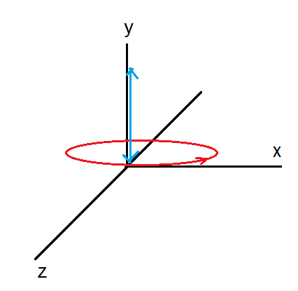

Without the electric field, the particle would move in the ( x,z) plane, perpendicular to the magnetic field, along a circle.

No. You can solve the y component at once. The x, z components correspond to circular motion. (Why?) Take the derivative of the first equation and substitute ## \frac{dv_z}{dt} ## into the third one.

It was the combination of a circular motion in the x,z plane and a vertical projectile motion in the direction of y. The period of the circular motion should be the same as the flight time of the vertical projectile.
