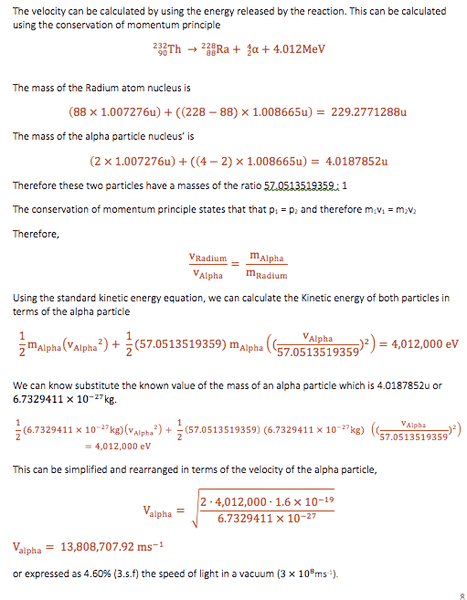

Basically having a problem when trying to theoretically calculate the mass of alpha particle in a charged field.
r is the unknown radius of curvature
m = mass of an alpha particle (6.646 *10^-27 kg)
v = velocity of an alpha particle immediatly after decay (1.381 *10^7 m/s)
q = charge of an alpha particle (3.2 *10^-19 C)
B = magnetic field strength (0.005 Tesla)
r=mv/qB
[/B]
Answer should be around 1cm but instead value is around 79cm. What's going wrong, am I forgetting something obvious. 1cm is published everywhere and was similar to my experimental results.
Thanks

What is the source of your data for the velocity of the alpha particle and the strength of the magnetic field? Those two would appear to be the only things in your scenario that are not intrinsic properties of the particle.
The field is just an exemplar of a lowly induced field and the velocity calculation is considerably more complex: (see picture)
This value is also similar to one found on Wikipedia (I know the source is awful I couldn't find it anywhere else)
The depicted velocity calculation is a bit overly detailed for the present purpose, but gives a value that seems reasonable to me. It essentially apportions the energy released according to the masses of the daughter particles (radium nucleus and alpha particle). That just leaves the magnetic field to wonder about.
For the velocity attributed to the alpha particle, what magnetic field strength would result in a trajectory radius of about 1 cm? It would have to be much larger than 0.005 T.
