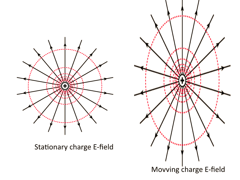

We all know that in the lab frame observing a charge moving along x-axis, we see an electric field ##E = \frac{Q}{4\pi \epsilon_0 x^2\gamma^2}##, picking up an extra factor of ##\gamma^2## at the bottom.
Assuming no external fields are present, what would the charge see in its own rest frame? It should see zero electric field, right? Since in the charge's rest frame, it only sees the lab frame moving and nothing else.

I don't think the ##\gamma^2## factor in the denominator is right; shouldn't it be ##\gamma## in the numerator?
Also, there would be a magnetic field, since there is a nonzero current density due to the moving charge. And the electric field would not be static; at any given point in the lab frame, it would be time-dependent, since the charge is moving so the distance to it varies with time.
No, certainly not. In the charge's rest frame, you would see the static electric field ##\frac{Q}{4 \pi \epsilon_0 r^2}##, without the extra factor of ##\gamma^2## and with no time dependence. But you would not see a magnetic field, since the charge is not moving in this frame.

I should be more specific. Charge is moving in S frame but not in S'.
Sorry I meant ##E = \frac{Q}{4\pi \epsilon_0 x^2\gamma^2}##. Yes there is a factor of ##\gamma## at the numerator, but there is also a factor of ##\gamma^3## at the denominator due to change of coordinates ##x'= \gamma x##.
So in the charge's rest frame, we see a stationary charge and ##E'_{||} = \frac{Q}{4\pi \epsilon_0 x'^2}##. The maths turns out right.

We are in agreement on how the field looks in the charge's rest frame: a static E field with magnitude ##\frac{Q}{4 \pi \epsilon_0 r^2}##, and no magnetic field. (Actually, we may not be in complete agreement, since as you'll note, I put ##r^2##, not ##x^2##, in the denominator. The static E field in the charge's rest frame is spherically symmetric.) But I don't see how you are getting from that to your expression for the E field in the frame in which the charge is moving. (Also, as I noted before, there is a B field in that frame; you haven't given a formula for that at all.)

I don't know that. For instance http://web.hep.uiuc.edu/home/serrede/P436/Lecture_Notes/P436_Lect_18p5.pdf (and also wiki) give the expression that the perpindicular component of E gets multiplied by ##\gamma##, (as opposed to ##\gamma^2## which is your claim), while the parallel component of E doesn't change magnitude at all. There is also a magnetic field generated by a moving charge, and an electric field generated by a moving magnetic field.

unscientific said:
I'm referring to the parallel component..
In the charge's rest frame, there's no such thing as a "parallel component"; the electric field is static and spherically symmetric.
In the frame in which the charge is moving, as pervect says, the component of the electric field parallel to its motion is unchanged from the charge's rest frame; only the component perpendicular to the motion changes.
