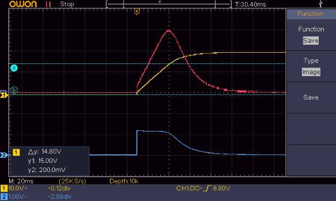

As to what charging a capacitor with a solar panel looks like, I recently did this experiment to test a solar panels power point voltage. I am simply charging a capacitor thru a 0.5 ohm resistor. YELLOW is the volts climbing to about 20V where the current BLUE eventually stops. The top flat portion is the panels Isc till it drops. RED is voltage multiplied by the current, power. That peak is the voltage where you can get the most power, Impp &Vmpp. It is nice to see science work just like the data sheets say.
