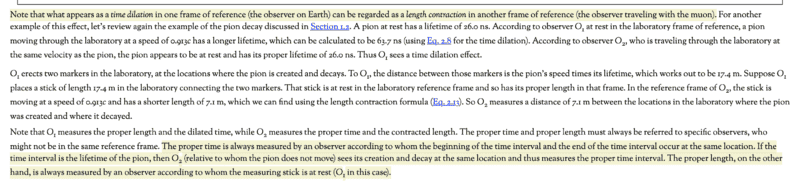

I just started learning about Special Relativity and have come upon the topics of Time dilation and Length contraction. Its a bit abstract for me and I just want to cross ref my knowledge here and see if someone can tell me if I am understanding this correctly. I've attached an excerpt of a passage in my textbook just for reference.
So if I am at rest and a particle passes by my at the speed of light, I am witnessing the particle with time dilation. If I was the particle, I would be witnessing proper time.
In the second instance, If I am at rest and measure the creation and decay of the particle then I am measuring Proper Length. This is because I am at rest wrt to the particle. But if I am the particle, moving at the speed of light, everything passing by me appears shorter because of how fast I am going?
So you either experience Time Dilation and Proper Length or Proper Time and Length Contraction.
Thats what i got from reading. Maybe there is other combinations of these 4 properties but for right now, is this correct?

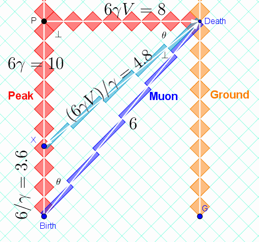

The first sentence is misleading. (What book is this?)
Time-dilation and Length-contraction are different geometric constructions on a spacetime diagram, despite the visual similarity of the associated algebraic equations when viewed through blurry glasses.
What is more correct to say is that
an observer in one frame may use "time-dilation" as an explanation of what was observed,
whereas another would use "length-contraction" in their explanation.
It's akin to finding an unknown feature (like a triangle side or angle or coordinate of an event)
using one triangle in approach A, and
then using a different (but geometrically similar) triangle in approach B.
For instance, see my answer (discussing the muon problem) in
https://physics.stackexchange.com/q...-distance-traveled-and-the-times-it-takes-why
From that answer (for a simplified muon),
and not using standard textbook methods (so hopefully this isn't giving the expected "answer" away)

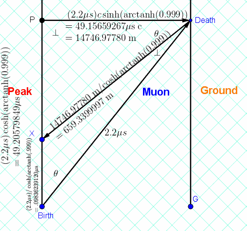

Time-dilation according to the lab involves timelike edge BP and timelike hypotenuse BD in Minkowski-right triangle BPD.
Time-dilation according to the muon involves timelike hypotenuse BX and timelike edge BD in Minkowski-right triangle BDX.
Length-contraction according to the muon involves spacelike edge PD and spacelike hypotenuse DX in Minkowski-right triangle DPX.
All three are Minkowski-similar right-triangles.
Details are in the link above...
for the simplified muon (using the diamonds)
and for the real muon (using hyperbolic trigonometry, where [itex] v=\tanh\theta [/itex] and [itex] \gamma=\cosh\theta [/itex] ).

The book is kenneth krane, modern physics, 4e
