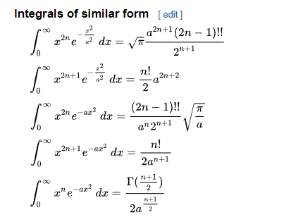

I see. How should I approach it then? I have been looking at Gaussian integral formulas; this is the best I could find
None of these fit the given integral though.

Next for me to understand is the range of convergence of this integral. Maybe I need to see the result of the the n-th integral first. I suspect that it should look similar to what follows
But instead of ##x^{2n}## we have ##x^{4n}##.
Might you please shed some light on how to compute the n-th integral and then on the range of convergence of the general integral? :smile:

[itex] \int_0^\infty x^{2n}e^{-ax^2}dx = \frac{1*3*5...(2n-1)}{2^{n+1}a^n}\sqrt{\frac{\pi}{a}} [/itex]
figure it out from here [itex] n \to 2n[/itex]

$$\displaystyle I_1 = 2 \int_{0}^{\infty} x^2 e^{-x^2}\,{dx}$$
Now, there are several methods to solve this integral. I particularly liked the one involving differentiation of ##e^{-x^2}##
$$\frac{d^2}{dx^2}e^{-x^2}=-2e^{-x^2}+4x^2e^{-x^2} \tag{*}$$Taking the integral of ##(*)##'s LHS yields
$$\int_{0}^{\infty}\left(\frac{d^2}{dx^2}e^{-x^2}\right)dx=\frac{d^2}{dx^2}\int_{0}^{\infty} e^{-x^2}dx=\frac{d^2}{dx^2}\frac{\sqrt\pi}{2}=0$$
Taking the integral of ##(*)##'s RHS yields\begin{align*}
\int_{0}^{\infty} \left( -2e^{-x^2}+4x^2e^{-x^2}\right) dx = 0 \Rightarrow \int_{0}^{\infty} x^2 e^{-x^2}\,{dx} = \sqrt{\pi}/4
\end{align*}
Hence ##\displaystyle I_1 = \sqrt{\pi}/2## So
\begin{align*}
&(2n-\frac{1}{2}) (2n-\frac{3}{2}) (2n-\frac{5}{2})...\frac{3}{2}\frac{1}{2}\ \ 2\underbrace{\int_0^{+\infty}e^{-t}d(\sqrt{t})}_{I_1} \\
&= \sqrt{\pi} \cdot (2n-\frac{1}{2}) \cdot (2n-\frac{3}{2}) \cdot (2n-\frac{5}{2})\cdots\frac{3}{2} \cdot \frac{1}{2} \\
&= \frac{(4n)!\sqrt{\pi}}{2^{4n}(2n)!}
\end{align*}
Which leads to the expected final answer, shown #25
