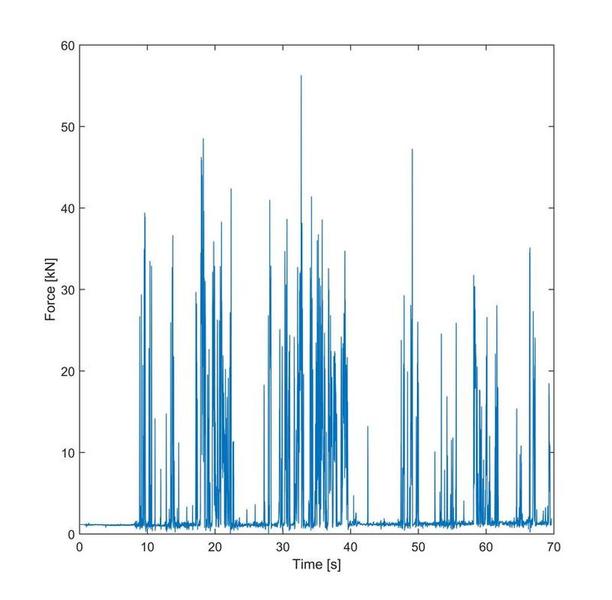

Hi all,
I have a signal and I need to check if it is stationary. I segmented a signal into different segments and for each I calculated the average value. It is enough to assess a weak nonstationary? Is there any limit value of the deviation of the average value of each segment with respect to the average value of all signal?
Thanks
Impossible to answer. For your circumstances, you (or someone who can establish the criteria) have look at the signal and determine when it is steady and when it is not. Then try to establish some criteria. Unsteady can mean anything (creep, spikes, noise). Comparing averages of segments may be ok, may be not.
Hi BvU,
thanks for your reply. Here is a signal sample:
It's spiky due to contact between a plate and granular material. In my opinion, the signal is nonstationary, but I'm searching a more scientific method for this verification and therefore I adopeted the segmentation approach and asked for suggestions in the forum. Hopefully it helps
I would certainly call this nonstationary. With signals like this you have a base level, some noise and huge spikes. I suppose the pikes are of interest and if the game is to detect them, a simple discriminator level would be my choice. First you make a histogram of the signal to determine the base level (around 1400 N is my guess), and the (harder) next step is to choose a discriminator level: a balance between missing small signals and raising 'false alarms'. The relative 'cost' of each of these two mishaps determines where it ends up.

Thank you for your reply. Nice the idea of the histogram. What I did is counting the time of base lavel with respect to the total time. May signal segmentation a fine approach for the evaluation of the stationary of this signal?

You still have to deal with the noise and place the cut between steady and disturbed somewhere...

Indeed, and the idea of histogramming the signal is to estimate steady level and standard deviation so that a reasonable discriminator level minimizes false alarms and missed instabilities.

False alarm is noise that is interpreted as a signal. Undesirable. Missing a signal is a spike that is interpreted as noise; undesirable too. The measure of undesirableness determines where you want to cut.
By now it is interesting to know what you consider a signal. Does each and every spike (like at 42 s) represent a signal or do you want to detect a burst like from 27-- 40 s ?
A low-pass filter does not improve the signal to noise ratio, I would say.
And averaging over 10 s (also a kind of low-pass) seems pointless: what do you want to extract from that ?
Frequency analysis isn't all that effective either: signal spikes <--> high frequencies and there is no autocorrelation.
I repeat #4: there is a base level of some 1400 N with a fairly low noise level (< 1kN) . So a discriminator at e.g. 2 kN would do a good job in my opinion.
Are these two spikes signal for you , or are they noise ? And the smaller one on the left ?

thanks for your reply. I think I haven't understand something.I believed burst was a synonym of spikes instead you mean for burst a spiky noise, right? In post #4 you spoke about a discriminator, you meant binning the force into intervals with of 2kN width? In that case, I made this plot:
I don't remember which is the testing condition of the plot above, so I recalculated everything. Here the baseline is almost zero. You can see the steep distribution that gradually goes down to the maximum value. Anyway, you're on right that the burst you isolated are suspicous but I cannot see what is going on when the plate is moving into the granular materia.
Good. Just suppose: if the noise is Gaussian (parabola in your plot) and the signal is Poisson distributed (straight line in your plot) you can eliminate most of the noise (at a cost of missing some of the signal) with a discriminator level of 4 kN. How many grains you miss and how many false signals you get you can estimate.
Binning from 0 to 10 kN in intervals of 0.1 kN should give you a clearer view of the parabola.
thanks BvU. So your idea might be to fit the distribution partially with a compound probability distribution? The boundary point between the two distributions will give me part of the histograms I have to cut?
There's no 'having to'. It's a tradeoff between errors (saying 'signal' when it's noise and vice versa). The point you describe is geneeerally a good choice though: below there will be more noise than signal and above there will be more signal than noise.
