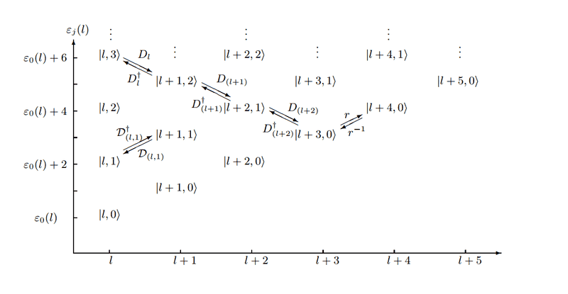

For part b) we are allowed to simply give an argument.In class we derived something like this picture:
(Source: http://arxiv.org/pdf/0808.2289v2.pdf, Page 5) where the y-axis is the HO energy levels. So, here is my attempt at an argument for whether they are eigenstates of [itex]l^2[/itex]...
For [itex]|\alpha_2>[/itex] the state will always be in energy eigenstate with [itex]E=\frac{5}{2}\hbar\omega[/itex] which corresponds to an inaccessible hole in the above figure, so it is NOT an eigenstate of [itex]l^2[/itex]. It IS an eigen state of [itex]l^2[/itex] since both states correspond to l=1.
For [itex]|\alpha_1>[/itex] it is a superposition of [itex]|0,0,0>[/itex] (accessible,defined [itex]l^2[/itex]) and [itex]|0,0,1>[/itex] (inaccessible). Since it is not strictly a superposition of accessible (and consistent) [itex]l^2[/itex] states, it is NOT an eigenstate.
Is there any merit to this?
EDIT: and for c) [itex][H,l_z]=0[/itex] so they are compatible observables...which means that if an H eigenstate exists, an [itex]l_z[/itex] must as well?
