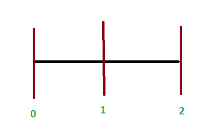

Aren't there two markers? One at the first meter and one at the second one?
Or am I wrong? (Thinking) (Blush)

Doesn't your picture show 3 markers? (Wasntme)
So, is there also a marker at the beginning of the road, before we have one meter? (Thinking)
Yep.
One at the beginning of the road, and one every meter, including one at the end of the road. (Wasntme)
