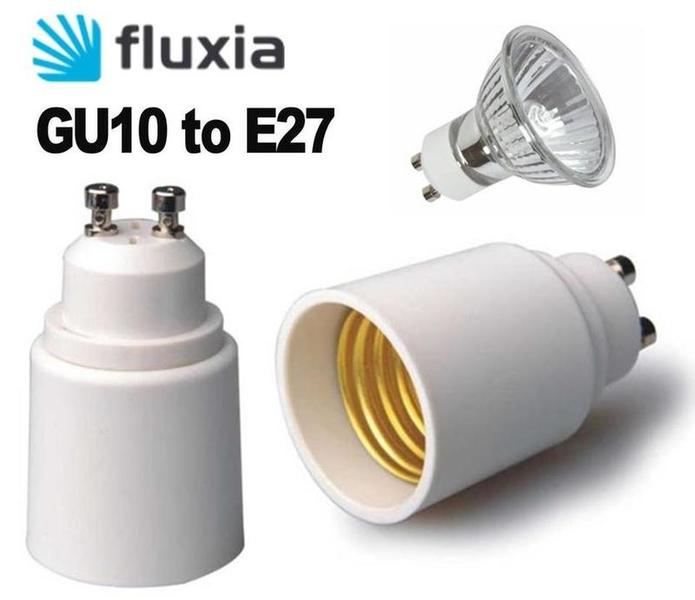

Glad you are okay and you just popped the breaker.
You most likely shorted Line and Neutral in the open socket with your voltage probes. The outer screw-shaped conductor is Neutral, and the small button at the bottom of the socket is Line (when the socket is wired correctly). As you reached for the bottom button, you probably made contact with both the button and the outer threads with the metal part of that probe.

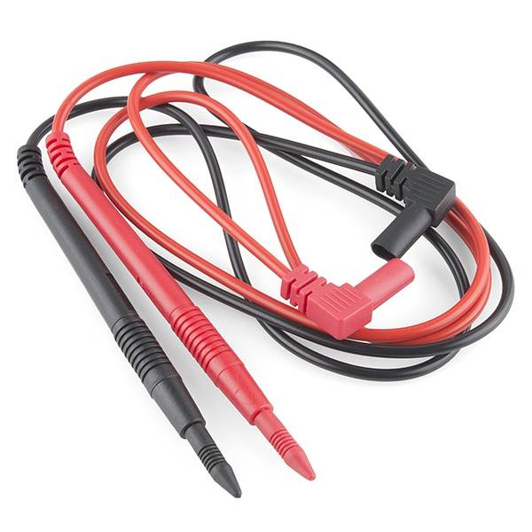

To do this test in a more safe manner, be sure to use probes that only have a very small amount of metal exposed near the end of the probe tip, with the rest covered by insulators.

Is it very likely that I can physically make contact with both Line and Neutral in the same time with such a probe?
Definitely. To temporarily use that probe until you get better ones, you could insulate most of that exposed metal probe tip with heatshrink tubing or electrical tape. Only leave about 1mm of the conductor tip exposed.
Oh, and please be careful. Why are you wanting to make this measurement? Measuring the voltage at the wall socket is a bit safer, as long as you are careful not to touch any metal with your hands or body when you are making the measurement.
