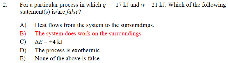

It looks like there is a mistake in the answer key. It should state that options A and B are both false. So in summary, the first principle of thermodynamics states that E=q+w, where q represents heat flow and w represents work done. In this problem, q=-17 kJ, meaning that heat flows from the system to the surroundings. Therefore, the process is endothermic, as it absorbs heat from the surroundings. However, the answer key states that only option B (false) is incorrect, when in fact, both options A and B are false.

First principle of thermodynamics: E=q+w
E=q+w=-17+21=4kJ>0
∴Endothermic (absorb heat from surrounding)
(a) false (from surrounding to the system)
(b) false (does work by surrounding)
(c) true
(d) true
the answer states only option b is false... why option a is true?
Thank you very much!
q=-17 kJ means that heat flows from the system to the surroundings. So "a" is not false.
And why are you using E=q+w=-17+21=4kJ>0 to say that
∴Endothermic (absorb heat from surrounding)?
I see. thanks.
It is impossible for only option B to be false. If B is false E is also false.
Likes DrClaude
Good catch.
