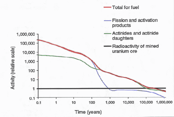

Has anyone published estimates for radiation levels at the end of the new containment's life. I'm wondering how much easier it might be to do dismantlement then? Or possibly to mine it for medically valuable isotopes.
That exclusion zone would have a nonzero value if the contaminants were removed. 100 years from now, that nonzero value could be higher.
Do you mean rad levels today, at the end of the existing sarcophagus, as it's called? Rad levels 100 yrs from now (life of the new structure) are predictable, would follow half life decay. That is, the level of all fuel and waste should fall by a factor of about 20X 8x in the next 100 years. After that, the actinides will dominate.
http://www.world-nuclear.org/upload...cle/Nuclear_Wastes/ActivitySpentFuel_IAEA.png
Likes anorlunda
mheslep said:
That is, the level of all fuel and waste should fall by a factor of about 20X in the next 100 years.
Based on your graph I get a factor ~8, with fission and activation products still dominating.
Still a significant factor, and dismantling technology is unlikely to get worse within the next decades.

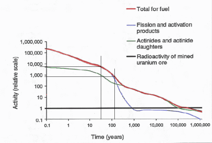

<shrug>
I'm starting 30 yrs post accident (appears to me from graph the activation ratio is ~10,000), going to 130 yrs (~250).
It is a log scale. The middle between 10 and 100 is sqrt(1000)=31 years, i. e. now (30.5 years).
In 100 years we are at 130 after the accident, log(1.3)=0.11 units behind 100 years.
The lines in the attachment lead to the corresponding activities, and doing the log->linear conversion backwards leads to a ratio of 8.
Likes mheslep
Yes I know, halfway, with activity 10000
And I had this wrong, thinking 300 (would have been in the middle again) instead of 130. Sorry for the trouble.
