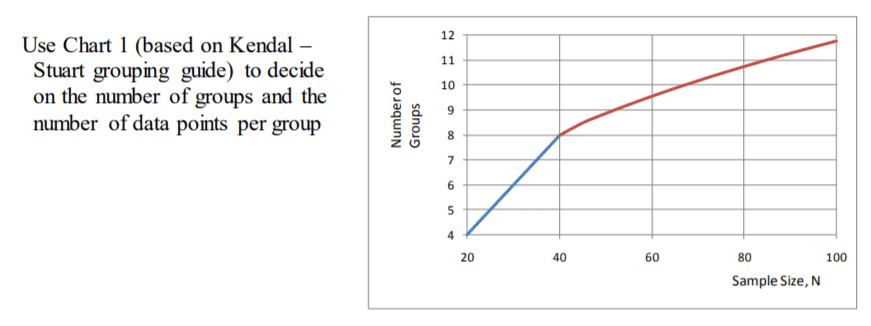

Sorry, I've just found this figure from my lecture note.
I suppose for data 3 it is not to do with any calculations and using mean and SD from either Data 1 or 2, it's just using this graph?
Data 3 with 66 data points will have 10 groups according to the graph.
How would I determine the number of members in each group though? Do you have any idea?

I have done the Chi squared analysis for Dataset 1 and 2. I just need to suggest a possible scheme for the number of groups and number of datapoints in each group for dataset 3. I've found the graph above, data with 66 data points should be split into 10 groups according to the graph.
66 / 10 = 6.6, I'm trying to figure out how many datapoints I should have in each group.
