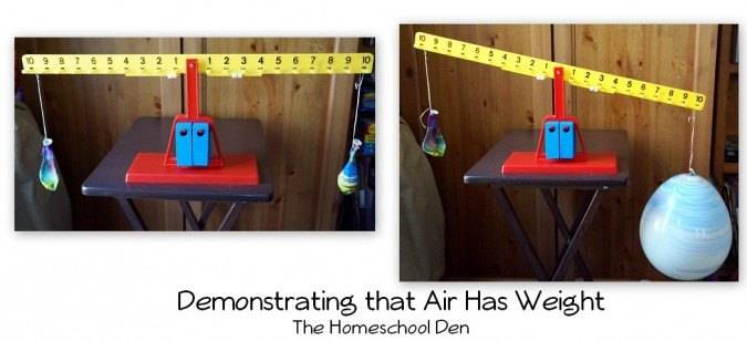

I think a published experiment that demonstrates the weighing of air is incorrect and actually only demonstrates that compressed air weighs more than non compressed air.
I've just purchased a book of child scientific experiments and it has an experiment that is titled 'Weigh some air'. It shows that if you make a scales with a piece of wood and a pivot and then balance two empty balloons on a either end and then fill one of the balloons with air the scales will tip demonstrating the weight of the air.
Something didn't seem quite right to me and after giving it some thought I've come the conclusion (that my more highly physics qualified friend disagrees with) that the reason the scales tip is because the air inside the balloon is compressed slightly and therefore has higher density and less buoyancy within air.
Even though the balloon filled with air has more mass relative to the unfilled balloon it still actually weighs the same when weighed in air because 'weight' depends not only on gravity and mass but also on the fluid or gas that the weighing takes pace in (hence why objects 'weigh' less when weighed in water).
The other way I'm thinking about this is that if you somehow had a rigid container made of a hypothetical material that had the same weight/volume ratio as air (so that it 'weighed' nothing in air) and filled it with air (so the air was uncompressed) than it would still weigh nothing no mater how big you made the container.
I'm getting a lot of stick from my friend on this (he's basically calling me a numpty) so would be great to hear your opinions (a lot of beer depends on it!)

Well, let's work it out. A balloon is "full" when the lungs can't provide any more overpressure. That's apparently about three-quarters of a pound per square inch. So air in the balloon is 5% denser than the air outside. Air is 1.3 mg/cm3. A 10cm radius balloon has about 4.4 g of air in it, so you're looking at a quarter of a gram difference.
Balance-beam scales can do this. A "piece of wood" is probably not able to. Furthermore, I doubt two "identical" balloons have the same weight to a quarter gram. My conclusion is that this can work, but the authors never tried it.
The correct way to do this is to have two filled balloons. Balance them. Let the air out of one, and see the other one is still heavier.

http://homeschoolden.com/2014/05/12/weather-unit-experiments-about-air/

lloyd709 said:
but my friend on reading them thinks he is being vindicated overall
He's right. Look a the pictures @Lnewqban posted. If that doesn't convince you, nothing we write will.
Of course different experiments will produce different results. But you didn't bet on those.
Likes Lnewqban
It doesn't convince me - those pictures just re-state the experiment that I've already described. My thoughts are that the balloon filled with slightly compressed air (because it's under pressure) goes down (for want of a better term) because it is overall more dense than the air around it. I hypothesis that if you swapped one balloon for a sealed but ridged container that contained air under no pressure and the other balloon for any weight identical to the container (but not a container just a weight) then on a perfect set of scales there would be no tipping. Just so we are clear, do you think it would tip yes or no?
You are correct. You have two explanations for the same experimental result. The experiment, as is, cannot distinguish between them.
