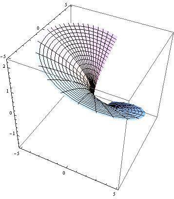

Now, it's easy to create any other branch. For example, I could excise a piece of the multi-function with a branch cut along the positive imaginary axis:
[tex]\text{mybranch}=|r|^{1/2}e^{i/2 t},\quad \pi/2<t \leq 5\pi/2[/tex]
with the code:
Code:
p1 = ParametricPlot3D[
  Evaluate[{Re[z], Im[z], Im[Sqrt[z]]} /. z -> r Exp[I t]], {r, 0,
   5}, {t, \[Pi]/2, \[Pi]}]
p2 = ParametricPlot3D[
  Evaluate[{Re[z], Im[z], Im[-Sqrt[z]]} /. z -> r Exp[I t]], {r, 0,
   5}, {t, -\[Pi], \[Pi]/2}]
Show[{p1, p2}, PlotRange -> All, BoxRatios -> {1, 1, 1}]

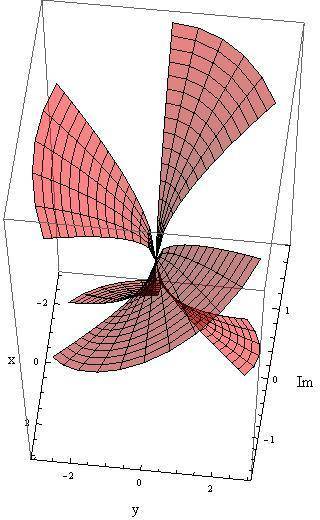

Now try and edit my code to place the branch cut at the negative imaginary axis and plot the results. In this case, you would want theta to go from [itex]-\pi/2[/itex] all the way round up to [itex]\pi[/itex] on the principal branch, and then go from [itex]\pi[/itex] to [itex]3\pi/2[/itex] on the n=1 branch, but since Mathematica will only plot the principal branch, we plot instead [itex]-\sqrt{z}[/itex] from [itex]-\pi[/itex] to [itex]-\pi/2[/itex]. Ok, that's probably really confusing. Sorry.
Here's the imaginary sheet of a perfectly-fine, single-valued branch of the square root function analytic everywhere except at the 5 branch cuts. When you can explain how, then I think you'll have a good understanding of the geometry of multivalued functions and how to chop them up into various single-valued "branches". :)

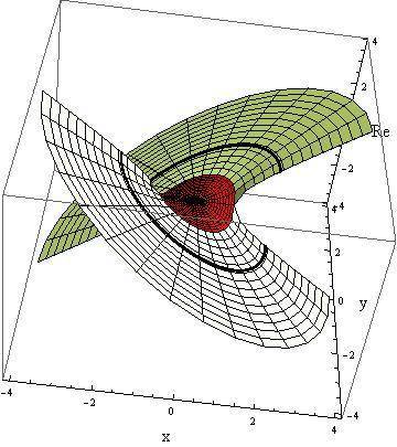

I do not feel that is adequate enough to completely describe the branch you're defining, that is, one with branch cuts [itex](-\infty,-1][/itex] and [itex][1,\infty)[/itex].
Rather, the function has two such branches, one of which could be defined as:
[tex]
\text{mybranch(z)}=\begin{cases} r^{1/2}e^{i/2(\text{Arg}(f))}, && 0<\theta\leq \pi/2 \\
r^{1/2}e^{i/2(\text{Arg}(f)+2\pi)},&& \pi/2<\theta\leq \pi\\
r^{1/2}e^{i/2(\text{Arg}(f))}, && \pi<\theta\leq 3\pi/2\\
r^{1/2}e^{i/2(\text{Arg}(f)+2\pi)}, && 3\pi/2<\theta\leq 2\pi
\end{cases}
[/tex]
with [itex]f=z^2-1[/itex] and [itex]-\pi<\text{Arg}(u)\leq \pi [/itex].
The real part of this branch is shown below along with a black contour reflecting [itex]\text{mybranch}(z)[/itex] with [itex]z=2e^{it}[/itex] as t goes from 0 to [itex]2\pi[/itex].
