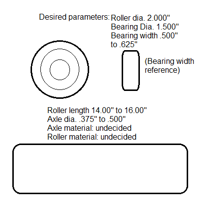

Alright, the application I will be using this roller is for assisting the unloading of cargo that isn't exactly fun by hand. The load these will be handling will be around 250 - 300lbs give or take during use at the most.
My first thought was to use a tapered roller bearing, but, it would require me to establish more than one part to retain within the roller. I have not decided on what I may chose for the roller material yet. I have not decided if I would like to have this a fully servicable (axle, bearings, races, retainers etc) or just a unit you replace.
Could someone fill me in on which design out there would be cost effective and best possible for this application?
Thanks, Jim

I need a lot more information before I can suggest anything. What is being moved? A pallet of boxes handles very differently than a length of pipe, or a sack full of rocks. How is the load being moved? How far? Permanent installation, or moved around as needed?
Jim.. can you post a sketch?

The roller would be 12 to 16 inches in width, undecided on the diameter but I would say 2 to 2.25 inches maximum diameter.
Product being moved would be trailer flooring for dry freight enclosed trailers. At the most weighs 5lbs per square foot. The boards range from 44 feet to upwards of 53 feet. I am not designing to handle multiple boards, but I am sure there may be someone out there that will end up overloading due to laziness of not moving the product off of it or just loading to much at one time. I have to take that into consideration. I am thinking of making it a piece that can be serviced if needed, but also looking at the possibility of an entire roller replacement would be more feasible. My first thought was to make it work with one area on the beam, but I could also think up a way to make it removable yet still stable when the load is applied during unloading.
The beam this will be adapted to is already produced and is readily available, I just have to figure out how to incorporate this into that and so on. The load is being moved by hand.
I will be sketching, although I have no scanner, I could try to find one and email it to myself. If need be, I can draw it up and snap a picture of it and go from there.

It would be really hard to make your own rollers any cheaper (considering labor) than what I found at McMaster-Carr:
2" X 16" steel roller (300 lb capacity) $12.06

I don't have a very clear picture of your process, but perhaps something with ball rollers would be more helpful.
http://www.ashlandconveyor.com/images/products/3MY75_bti_22_wwg.jpg
These let you move the load in any direction.

Here is a basic rendering of my view. I did not go into extreme detail simply because my computer software does not have the capabilities, sketching was out of the question as well, still.
I have not decided yet how to secure or incorporate it to the beams that are used.
