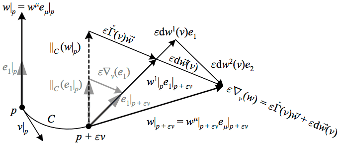

For those running across this thread who might be helped by a picture, I thought I'd add the below.
So the covariant derivative ##\nabla_{v}w## can be described as "the difference between ##w## and its parallel transport in the direction ##v##," and the relation ##\nabla_{v}w=\check{\Gamma}\left(v\right)\vec{w}+\mathrm{d}\vec{w}\left(v\right)## can be viewed as roughly saying that "the change in ##w## under parallel transport is equal to the change in the frame relative to its parallel transport plus the change in the components of ##w## in that frame."
Here the notation is such that the following are all equivalent:
$$\begin{aligned}\nabla_{e_{\mu}}w & =\mathrm{d}\vec{w}\left(e_{\mu}\right)+\check{\Gamma}\left(e_{\mu}\right)\vec{w}\\
\nabla_{\mu}w^{\nu} & =\mathrm{d}{w^{\nu}}\left(e_{\mu}\right)+\Gamma^{\nu}{}_{\lambda}\left(e_{\mu}\right)w^{\lambda}\\
\nabla_{\mu}w^{\nu} & =\partial_{\mu}w^{\nu}+\Gamma^{\nu}{}_{\lambda\mu}w^{\lambda} \end{aligned}$$
This means we can describe the Christoffel symbols ##\Gamma^{\nu}{}_{\lambda\mu}## as "measuring the ##\nu##th component of the difference between ##e_{\lambda}## and its parallel transport in the direction ##e_{\mu}##."
More on this approach here.
