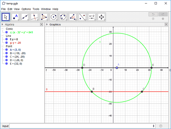

I'm requiring help on a circle geometry question I've done.
The line L, has equation of y=0, and intersects the circle with (3,0) and radius of 29. Find the points of intersection.
My working out:
292 = 841
It's centre is 3,0,
Inserting that in circle equation gives (x-3)2+y2 = 841
Solving simultaneously,
(X-3)2 + y2 = 841 (1)
y=0 (2)
Sub (2) into (1)
(X-3)2 + 02 = 841
x2 -6x + 9 = 841
x2-6x+9-841=0
x2-6x-832=0
(X+26)(x-32)=0
X1= -26 and x2= 32
I'm stuck on what to do after this, I think I use process of elimination, however I'm not sure on the equation of y=0, as its confusing me with the zero and no other coefficients. Can someone help?
Thank you.
On the line y=0, x can have any value and y is always 0. So at the x values that you calculated, x=-26, and x=32, what y values would put it on the line?

Wouldn't the y values be 0, to put the x coordinates in the line? I have drawn the graphs, but I still don't get the correct answer.
The mark scheme says it intersects at (24,-20) and (-18,-20) I am not entirely sure where those values are from...

Either the marking scheme is wrong or you have copied out the question incorrectly. On the line y=0 the intersection with the circle will always have second coordinate = 0.

That would be the correct answer if the line were ##y=-20##.

Sorry, I was not clear. Your answer is correct for the line y=0 and the book answer is wrong . As @tnich stated, the book answer is correct for y=-20.

Yes, the points in your answer are on the y=0 line. So (-26,0) and (32,0) are correct for the problem that you stated.
Likes Physiona
If y=0 the problem seems rather too easy. It really looks like a typo and it should be y=-20.
