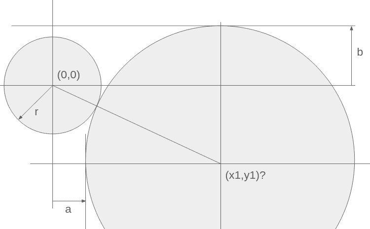

Find center of a circle tangent to perpendicular lines x=a and y=b, and also tangent to a circle of radius r at the origin.
I'm trying to solve this for a model I'm making in OpenSCAD.
Given a circle of radius r centered on the origin, and two perpendicular lines at x=a and y=b, where is the center (x1,y1) of a circle that is tangent to both lines and the centered circle?
Here's a picture:
I thought it would be easy, like solving for a circle that intersects 3 points, but there's something I'm not getting here. It's been 4 decades since I had to solve problems like this.
I know that the distance between (0,0) and (x1,y1) should be the sum of the two radii. I could solve it iteratively, but it feels like there should be a closed-form solution here.

You have three unknowns, ##x_1, y_1, r_1## and three equations from the three tangent conditions. You will need to solve a quadratic equation.
Thanks, I believe I figured it out.
From the diagram, I have
##x_1^2+y_1^2 = (r+R)^2##
where ##R## is the radius of the unknown circle. I also know that ##x_1=a+R## and ##y_1=b-R##. That means
##(a+R)^2 + (b-R)^2=(r+R)^2##
and I have a quadratic expression with one unknown, ##R##. That can be solved by the quadratic equation, and I get this:
##R=b-a+r \pm \sqrt{2}\sqrt{(r-a)(b+r)}##
With that I can solve for ##(x_1,y_1)##.
