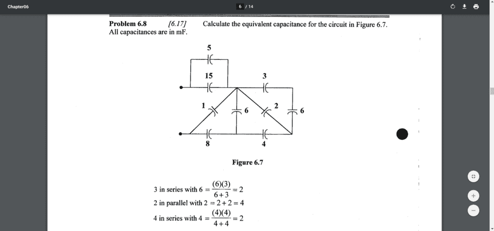

when we say two components in circuit are in parallelries,there are prerequisite for the components,for example,we cant state that two nodes are in parallel,so what exactly are the prerequiste
no specific
par
Two branches of a circuit are said to be in parallel if they are connected between the same two nodes, with no intermediate connections to either branch.
