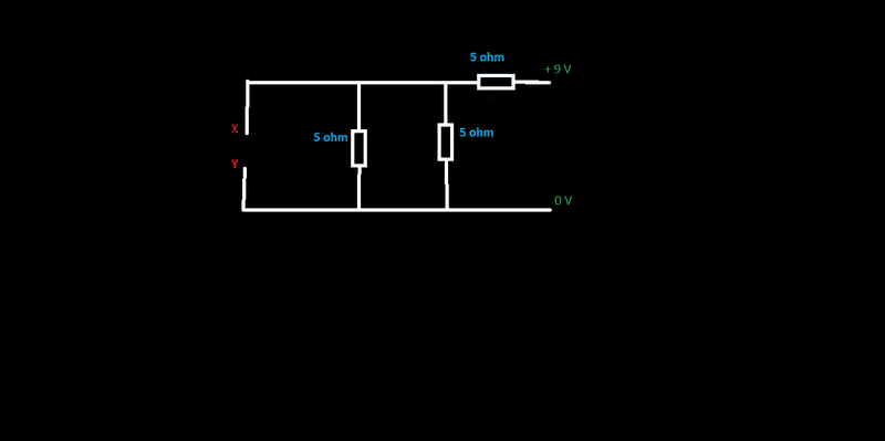

What is the Potential difference between X and Y ?
KVL and KCL
I am confused about the two possible answers :
1. 9V (From general concepts)
2. 3V (after applying the KVL and KCL)
I think the 2nd answer looks correct. Any thoughts ?
Can someone give a description and an explanation for this answer .

Can you explain the reasoning, or preferably the calculations, behind the two suggested answers? Where did they come from?

Ofcourse !
using KVL :
9 - 5[itex]I_{1}[/itex] - 5[itex]I_{2}[/itex] = 0 >>>eq 1
9 - 5[itex]I_{1}[/itex] - 5[itex]I_{3}[/itex] = 0 >>>eq 2
[itex]I_{1}[/itex] = [itex]I_{2}[/itex] + [itex]I_{3}[/itex] >>>eq 3
By comparing eq 1 and eq 2 : [itex]I_{2}[/itex] = [itex]I_{3}[/itex]
Now by substitution we find that : [itex]V_{1}[/itex] (voltage across the first resistor the one closest to the 9V rail) = 6 V
This leaves 3 V for the resistors in parallel and hence the terminals X and Y.
Is this reasoning sound for rejecting the answer 9V (across X and Y) and confirming the answer as 3V (across X and Y) ?

Yes, the method is fine and the result, once the stated equations are solved in detail, will give the correct result and allow you to reject the other one.

I didn't see a complete answer... just some (correct) steps along the path to one :smile:

3 V
There is no working left to show (excluding solving the linear equations)

All right, so 3 V is correct using KCL and KVL.
Now, what about this "9V (From general concepts)" option? What's the argument for that, and is it good enough to discount the KVL/KCL solution?

I will actually have to upload another circuit to prove my point here
I used this circuit (only a little different than the first) as a reference that if no current flows through the circuit, the p.d across any component is always the same as the e.m.f of the source . Although, given that I worked out the math, I would disregard this flawed concept of mine.

Yup. This new circuit lacks the resistance in series with the voltage source, so it's strictly a parallel circuit where all branches have the same potential which is the same as that of the voltage source. The lack of the series resistor is a critical difference.
