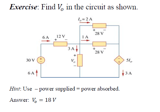

In summary, the question is asking for the power that is supplied when a load is connected to a voltage source. The power that is supplied is 180 + 15 x.

As shown below.
Now, I know this question can be solved using Kirchoff Voltage rule, but the question expliciitly wants me to use power supplied = power absorbed. Hence taking V0 to be x, I can't still seem to calculate. Any ideas?
Power supplied = (60)(3) + (5x)(3) = 180+15x
Power absorbed = 72+ 56 +28 + 3x
``180+15x = 72+ 56 +28 + 3x
x =2 which is obviously wrong. Any ideas?
The dependant source voltage is 5IO. IO is known.
Is there something wrong with this exercise ? I see 30 V on the left and then 12 V over the top left resisitance.
So the 1`8 V is a giveaway !
I suppose that is what the OP means with
You used x for I0 in the top equation and x for V0 in the bottom equation.
Likes SammyS
Hmm seems like you are correct. But with now having two separate variables, how do I solve them now?
``180+15y = 72+ 56 +28 + 3x where y is I0 and x is V0
I0 is 3A right? So wouldn't the power be (5*3)A *V0?
IO is 2A as indicated (at the top of the circuit). Why do you think VO has anything to do with the power supplied by the dependant voltage source?
Sorry for being careless wow :/ Got the answer too, thanks
