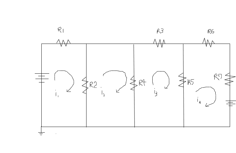

Find the value of N(1,2,3) in attached circuit
I've found i(1,2,3,4) from mesh analysis as:
[tex] i_1=1.44159mA,i_2=0.919142mA,i_3=0.396691mA,i_4=-0.08609047mA [/tex]
now I am having trouble finding N_2 and N_3 from this.
Thanks for any help.

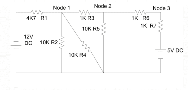

Don't let the schematic confuse you. It might help to redraw the circuit as below. Redrawing in this manner does not affect the nodes, since the voltage is the same across a wire. I assume that the four mesh currents you found are from redrawing as I did below. The voltage at Node 2 is the voltage across R5, which is, based on my diagram, (I3-I4)R5. The voltage at Node 3 is a simple voltage divider, and if we draw a path from ground to that node, we get: 5V + I4*R7 = Voltage at Node 3.

I did see that, what I have for N_2 is N_2=N_1-(1000i_3) but it doesn't work. I know my currents are right because I have checked in multisim. N_2 should equal 4.81V but I can't get this.
Thanks
Sorry, I edited my post. Reread what I had done. If you do what I said for Node 2 you will get the right answer:
Voltage at Node 2 = (I3-I4)R5 = (0.396691mA--0.08609047mA)*10000 = 4.83V
A bit off, perhaps a rounding error, but I believe this is correct. Just remember, when you are trying to find those node voltages, you must subtract the mesh currents as I did, i.e. I3-I4, since the current going down that branch is indeed I3-I4 based on the way I redrew the schematic. The same process follows for Node 3.
Thanks for your help Maru
I just did N_2 and it doesn't work, it gives me 48.27V?
sorry yes it does
