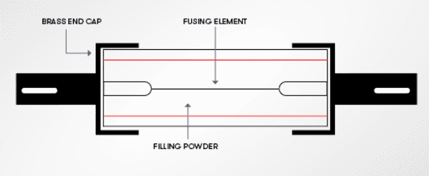

Forget the voltage. The fusible strip has some resistance R. The heat dissipated in a section of wire with resistance R is I2R. So given the R and the trip current I, that tells the designers how much heat should trip it. Then they select materials with a low melting point to match. (That's one approach, there are others.)
Fine tuning is done by adjusting the width of the fusible part to a narrow neck, shown schematically in the picture below. The narrower the neck, the more resistance per unit length. Sometimes in glass fuses, you can see the neck.

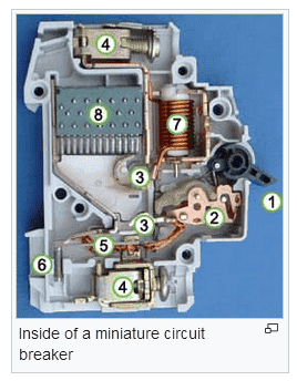

I really like the picture posted by @berkeman . The label 8 in the picture shows the arc divider/extinguisher. That is what makes it different than a switch. A circuit breaker expects that an arc will form between the contacts as they begin to open. An arc carries current so that can defeat the purpose of shutting off the current. A circuit breaker, but not a switch, has special parts designed to get rid of the arc as quickly as possible.
A normal switch does not expect, nor can it handle, significant arcing.
Likes Klystron and berkeman

Not to split hairs, but I think an uninformed reader (maybe that's me?) could come away from this thread with the wrong impression about how typical domestic circuit breakers work. They do have a magnetic component for large instantaneous overloads, but they also typically have a thermal mechanism for smaller, sustained overloads. both are really required for the best combination of protection and non-nuisance operation.
Likes russ_watters, berkeman and hutchphd
Correct. Here is the Wikipedia text that describes the picture @berkeman posted in #3
  1. Actuator lever - used to manually trip and reset the circuit breaker. Also indicates the status of the circuit breaker (On or Off/tripped). Most breakers are designed so they can still trip even if the lever is held or locked in the "on" position. This is sometimes referred to as "free trip" or "positive trip" operation.
  2. Actuator mechanism - forces the contacts together or apart.
  3. Contacts - allow current when touching and break the current when moved apart.
  4. Terminals
  5. Bimetallic strip - separates contacts in response to smaller, longer-term overcurrents
  6. Calibration screw - allows the manufacturer to precisely adjust the trip current of the device after assembly.
  7. Solenoid - separates contacts rapidly in response to high overcurrents
  8. Arc divider/extinguisher
My curiosity was aroused, so I found a 15 amp 120 volt Square D circuit breaker in my electrical stuff box, and connected it to a power supply. At 3.1 amps through the breaker, the voltage across the breaker was 0.051 volts measured at the breaker. That's a resistance of 0.016 ohms. The voltage across the breaker would be 0.25 volts at 15 amps, so the power dissipated in the breaker would be 3.7 watts at 15 amps.
That amount of heat would eventually make the breaker warm to the touch.
Likes hutchphd, GregJ7 and berkeman

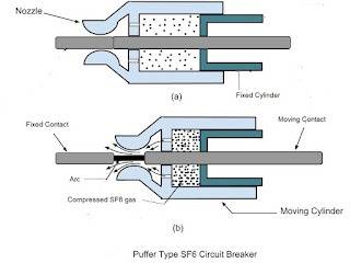

Brings back memories of the "puffer breakers" I've seen in substations.
