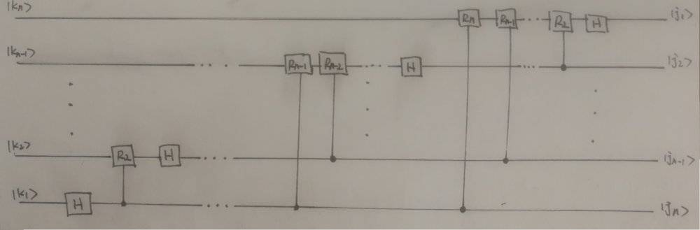

Give a quantum circuit to perform the inverse quantum Fourier
The quantum Fourier transform is defined as ##\left | j \right > =\frac 1 {\sqrt {2^n}} \sum_{j=0}^{2^n-1} e^{2 \pi ijk / 2^n} \left | k \right >##, and it is equal to ##\left | j_1 , j_2 , \dots , j_n \right > \rightarrow \frac { \left ( \left | 0 \right > + e^{2 \pi i 0.j_n} \left | 1 \right > \right ) \left ( \left | 0 \right > + e^{2 \pi i 0. j_{n-1} j_n} \left | 1 \right > \right ) \dots \left ( \left | 0 \right > + e^{2 \pi i 0. j_1 j_2 \dots j_n} \left | 1 \right > \right ) } {2^{n/2}}##
First, the inverse quantum Fourier transform is ##\left | k \right > =\frac 1 {\sqrt {2^n}} \sum_{j=0}^{2^n-1} e^{-2 \pi ijk / 2^n} \left | j \right >##, and it is equal to ##\left | k_1 , k_2 , \dots , k_n \right > \rightarrow \frac { \left ( \left | 0 \right > + e^{-2 \pi i 0.k_n} \left | 1 \right > \right ) \left ( \left | 0 \right > + e^{-2 \pi i 0. k_{n-1} k_n} \left | 1 \right > \right ) \dots \left ( \left | 0 \right > + e^{-2 \pi i 0. k_1 k_2 \dots k_n} \left | 1 \right > \right ) } {2^{n/2}}##
where I merely change the signs in the exponentials.
Second, since the quantum circuits are reversible, then I think if I reverse the quantum Fourier transform circuit, then I should have the circuit for the inverse quantum Fourier transform as I did in the picture:
Then, I tried to calculate the outcome of the circuit:
## \left | k_n \dots k_1 \right > \\ \rightarrow \left | k_n \dots k_2 \right > \frac {\left | 0 \right > + e^{2\pi i 0.k_1} \left | 1 \right >} {\sqrt 2} \\ \rightarrow \left | k_n \dots k_3 \right > \frac {\left | k_2 , 0 \right > + e^{2\pi i 0.k_1 k_2} \left |k_2, 1 \right >} {\sqrt 2} =\left | k_n \dots k_2 \right > \frac {\left | 0 \right > + e^{2\pi i 0.k_1 k_2} \left | 1 \right >} {\sqrt 2} \\ \rightarrow \left | k_n \dots k_3 \right > \frac {\left | 0 \right > + e^{2\pi i 0.k_2} \left | 1 \right >} {\sqrt 2} \frac {\left | 0 \right > + e^{2\pi i 0.k_1 k_2} \left | 1 \right >} {\sqrt 2} \\ \dots \\ \rightarrow \frac { \left ( \left | 0 \right > + e^{2\pi i 0.k_n} \left | 1 \right > \right ) \left ( \left | 0 \right > + e^{2\pi i 0. k_{n-1} k_n } \left | 1 \right > \right ) \dots \left ( \left | 0 \right > + e^{2\pi i 0.k_1 k_2 \dots k_n} \left | 1 \right > \right ) } {2^{n/2}}##
which does not match the previous equation. The signs in the exponentials are positive instead of negative.

Also, I know that Hadamard gate can be expressed as ## \left | k \right > \rightarrow \frac {\left | 0 \right > + e^{2 \pi i 0.k} \left | 1 \right > } {\sqrt 2} = \frac {\left | 0 \right > + e^{-2 \pi i 0.k} \left | 1 \right > } {\sqrt 2}## where the negative sign appears in the exponential. Then how can I get other negative signs out? Should I change ##R_k=\begin{pmatrix} 1 & 0 \\ 0 & e^{2 \pi i/2^k} \end{pmatrix} ## to ##R_k=\begin{pmatrix} 1 & 0 \\ 0 & e^{-2 \pi i/2^k} \end{pmatrix} ##? If so, I believe the origin circuit is right for the inverse quantum Fourier transform.
Yes, I believe so. To reverse the circuit, you would need to reverse the action of each gate.
Likes Haorong Wu
Hi, tnich. Sorry to get back to you this late.
I forgot to exchange the inputs and outputs of the ##R_k## gates. After the exchange, ##R_k^{-1}= R_k^{\dagger}=\begin{pmatrix} 1 & 0 \\ 0 & e^{-2 \pi i/2^k} \end{pmatrix} ##. Then everything works out.
Thanks!
