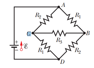

We wish to find Va-Vb given that R1 = 1000 ohm, R2 = 2000 ohm, R3 = 3000 ohm and emf = 10v.
I started by trying to simply the circuit but couldn't do so because of R3.
then i decided to add potential differences and currents.
Let the current from
DA = I1
AC = I2
AB = I3
CB = I4
CD = I5
BD = I6
loop: ACDA
-I2R2 - I3R1 + emf = 0
loop: ACBDA
-I2R2 - I4R3 -I6R2 +emf =0
loop: ABDA
-I3R1-I6R2+emf =0
current sum
I1 = I2+I3
I2 = I4+I5
I6 = I4+I3
I1 = I5+I6
And i am not sure how to go from here?
Do i put them in a matrix and get rref then backtrack?

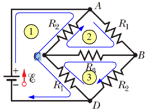

In your attempt, you have assumed 6 currents. Instead, assume only three currents in the beginning and write the other three as the addition or subtraction of any two of these three. For example, current through AB is i1, through AC is i2 and through BC is i3 (from B to C) . Current through BD is simply i1-i3 and current through CD is i2+i3. Write proper KVL equations and solve for 3 variables i1, i2 and i3.

Okay, then you're going to have to work through the simultaneous equations. Write KVL loop equations for three loops using the currents that you've identified. I suggest the obvious loops:
although you are free to choose any three independent loops so long as every component is included in at least one of the loops.
Then work the KVL and KCL equations to solve for current I3 (the one you've identified as flowing from A to B).

sorry for replying so late(was studying for a test)... i found the textbook and it says something about the currents going through the resistors are the same because they are symmetrical. So that the current from ab is equal to the current cd but I have not read anywhere that states this. Could you explain? I mean i know that if the R3 was not there then the resistance would be equal(R1+R2= R2+R1) and the current would just be I/2 for each of the path.
The most convincing way to show that those currents are equal would be to solve the circuit. But there are arguments based on symmetry that can be used to convince you that it is so.
Suppose you were to reverse the polarity of the voltage source. Since no other changes are made to the circuit you can be sure that the only change in the currents would be to their directions (reversed). By symmetry path DC now has the same role that path AB had previously, the circuit configuration being topologically identical (just rotate the image 180°). So the current magnitude must be the same as before. Flip the voltage source polarity again and the current directions are restored and their magnitudes are kept the same. So the current AB must equal the current CD.

Without R3 the current through A - C would be the same as the current through A - B. However the voltage across A - C (6 2/3V) would be twice the voltage across A - B (3 1/3V). The voltage difference between C and B is 3 1/3V. This source of current when adding R3 3000 Ohms will increase the current through A - B and decrease the current A - C. You still have to solve the mystery.

R3 adds to the imbalance in the current of the left and right branches and the two R1 resistors do not carry identical currents with R3 present. Op said "We wish to find Va-b."
Likes NascentOxygen
An "imbalance" in the potentials at nodes B and C does not preclude the currents through the two R1 resistors having the same magnitude (and vice versa).
For example, suppose that the battery EMF was 12V and that the identical currents through the R1's was such that they drop 4 V, while the currents through the R2's both drop 8 V. For both sides of the bridge the total potential drop is 8 + 4 = 12 V, and there will be a potential difference of 8 - 4 = 4 V across the bridge resistor.
