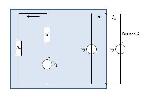

Take the following example.
Here, even if the network has infinite solutions for the current through the branch A, we can successfully apply the theorem to the branch A: for each of the branch A current solution of the initial network, the replaced network has got an unique solution and that's of course the solution of the initial network for that specific branch A current value.
Again, if the theorem applies to any chosen branch of the network then the assumption of uniqueness of the initial network becomes required of course
What do you think about, does it make sense ?
Yes - I think this is a precondition for the applicability of the theorem...

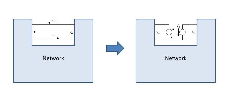

Ok. Take now the following scenario
Assume the overall network has a unique solution with equal currents ##I_a## through the drawn pair of wires: the definition of port is met -- even if in this case there exist no topological cut across them.
Let's assume the network drawn on the right has got an unique solution (there the pair of wires has been replaced by two current sources with value ##I_a## equal to the port current solution of the initial network).
Does it make sense to apply the substitution theorem also in this scenario ?
Any comment on this ? Do you think it is actually the same case as before ?

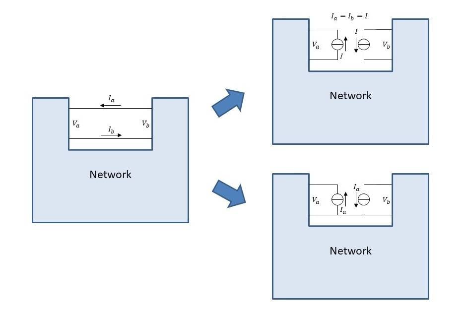

Help !
Compared to my previous post #8 consider now the equivalence shown on the bottom right.
I believe it applies to the general case where the currents ##I_a## and ##I_b## through the two wires are different (as before we assume the hypothesis of unique solution for the initial network and the replaced one).
