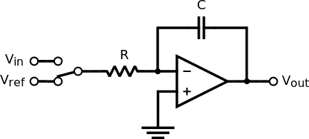

Start out with something like this. Assume Vin=-Vref and use a comparator on Vout. Let the incoming pulse flip the switch to Vin. The integrator will integrate -Vin for the time the incoming pulse is active. The switch will then flip to Vref and the integrator will integrate back to 0. At that point, clamp the integrator.
http://www.hardwaresecrets.com/imageview.php?image=3741
Likes hamburg21
Very nice! I agree that this will make f(x) = 2x! Did you just think this circuit up or is it used for some application?
I imagine you can stack these to make f(x) = 4x, etc. I wonder how to do f(x) = x^2...
This is a variation on the "dual slope A/D converter" design. The way I designed it, f(x) = (1+Vin/Vref). You are, of course, free to create your own versions. Look up "dual slope" on the web.

This is straining the analog circuits, but two integrators in series create an amplitude proportional to x2

Yes, since [itex]\int_{0}^{x}\int_{0}^{x}1dt=\frac{1}{2}x^{2} [/itex].

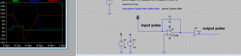

Yes, I am putting a logic gate on the output and then tuning the logic gate threshold. See attached photo of the simulation. As I raise the threshold of the gate, the triangle signal remains below the threshold longer, and gives me a larger multiplicative factor.
true.
true.
that is VERY nonlinear.
also i recommend adding a resistor as seen in teh above circuit diagram.

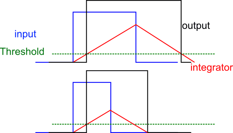

I am lost with respect to this. All I am trying to do is implement a circuit that:
1) I inject a single pulse of width x
2) the circuit responds by giving me a single pulse of width f(x)
This can be done for f(x) = mx using an opamp integrator circuit and a logic gate. The opamp integrator makes a triangle wave and the logic gate triggers off of it when it crosses the thresholds.
  • #33
I realize that. you are misunderstanding the purpose of the comparator. it does not in any way contribute to your pulse with manipulation (if you set the trigger low enough). its purpose is to provide a stable voltage to the logic

you have a circuit that does the correct thing, but completely misunderstood my comment about the comparator

I think there is a big misunderstanding. You guys are making me feel like I am taking crazy pills. See attached.
