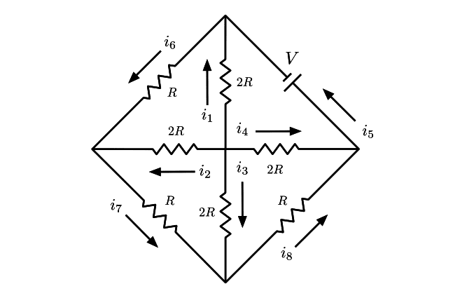

Okay so we are given this circuit. I do not want to be told step by step what the answer (or worked solution is) but I am wanting some guidance about how I can start/continue on from what is given to us.
We obviously need a understanding of Kirchoff's current law.
Our task is to construct the remaining equations and then solve for the currents i1 to i8 in terms of V and R.
Okay so I know Kirchoff's current law that says that there is a conservation of charge. that is if there is only two wires one has current going in, the other equal going out. So the sum of all currents at node = 0A, and total charge in closed loop is zero. Also know Ohm's law is V=IR.
[/B]
With that in mind we know:
0=i1+i2+i3+i4
and V=i6R+i7R+i8R
We can for instance combine the left triangle which has R and 2R and 2R all in parallel which should give us ((1/R) + (1/2R) + (1/2R) ) -1? Am i heading down the right path? And since that all combines to be one resistor that is parallel to the bottom left triangle which has a R and 2R again?
and so on and so forth? How do I do the current? Could it be like i2+i6=i7?
Thanks a lot!

Have you thought of using unkown voltages instead ? You would only need three variables then .

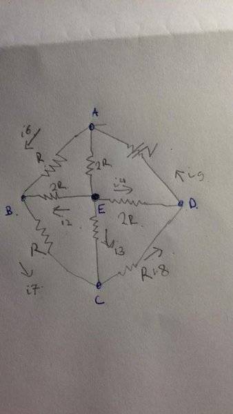

Could you by any chance label the junctions ? It is going to be a bit difficult to explain without it .
You mean like this?
Yes , that's better . Now , let potential at A be zero , and V at D .
You will have three unknown voltages - V1 , say , at E , V2 at B , and V3 at C .
Now write junction law at E , B and C , using voltages and resistances . You thus have three equations , three variables . Solve and find the variables' values .
Can you now write each individual current ?
Hope this helps .
@SteliosVas ,
Use symmetry to simplify the circuit.

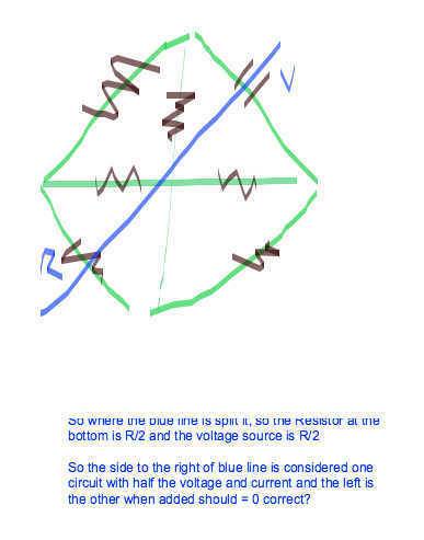

What do you mean by symmetry? Sorry I do civil engineering not really too fond on electrical associated stuff.
So do you mean look at the left hand side of the circuit and than take the same for right? But doesn't it matter that the top right branch has a voltage source?

The circuit is symmetric about a line that goes through the middle of the voltage source, the middle of the circuit, and the middle of the resistance with i7 flowing through it. If you divide the voltage source in 2 voltage sources in series, both with potential difference V/2, and the resistor into two resistances R/2 in series, the 3 points on the symmetry axis all must have the same potential, If you connect them with wires, the rest of the circuit can be quickly solved with the rules for series and parallel resistors.

Do you mean something like this?
Yes, something like that.
You left out the 2R resistor between points E and C.
However, it's not two separate circuits the way you described it. If you split it that way neither part would be a circuit.Here's a different question to clarify what convention you may be using regarding current.

I didn't read willem2's post #10 carefully enough, previously.
That may be a simpler way to analyze this circuit.
Okay analysing it your way. How should I start? It's more the beginning that is the most difficult.
If you draw a line across the voltage source therefore anything lying on that line must (I think equal =0) so saying that one resistor will have value R/2 and the junction E a value and v/2?
Using that should I than analyse the top and bottom segments ?
It is all the same voltage along that line. Maybe not zero.
At any rate, you can connect all along that line with a wire.
Which way do you want to analyze it?
The way willem2 suggests?

I would not have pursued "symmetry" quite as literally as the foregoing respondants.
Examining the pathways and resistor values, you can see that between point E and the top of the battery (i.e., the +V volts point) is exactly the same arrangement as between point E and the bottom of the battery (i.e., the 0 volts point). So, by symmetry, point E must be at a potential that is midway between +V and zero, meaning E must be V/2 volts.
Back to the circuit, you can see that between node B and the top of the battery is the same arrangement as is seen between node C and the bottom of the battery. Consequently, if we say node B is x volts less than the potential at the top of the battery, then, its corresponding node under symmetry is going to be x volts more than the potential at the bottom of the battery.
So, this leaves us with only one unknown in the whole circuit, viz., x. Once we know x we'll know the voltage at every node and hence the voltage across every resistor.
➤ Apply Kirchoff's and Ohm's Laws to determine x.
Likes SteliosVas

Okay so my understanding is you are saying basically the branch between B and the top of the batter is the same as C and the battery because the value of the resistor is R.
Since the voltage at E is 1/2 the branch at top will be the potential at E - a certain difference and bottom will be E + the certain difference.
SteliosVas said:
Okay so my understanding is you are saying basically the branch between B and the top of the battery is the same as C and the battery because the value of the resistor is R.
No, I didn't attribute it to any single resistor. There is a complicated arrangement of resistors between B and both terminals of the battery, and we can't easily simplify it. But whatever it is, we can see there is an identical/symmetrical arrangement positioned between C and the battery terminals. And that's all we need to know---that from both points B and C the resistor-battery arrangement is identical [in symmetry]. This allows us to state---without further ado---that the +V battery terminal and point B have the same voltage difference as that between point C and the 0 volts end of the battery.
Likes SteliosVas
Thanks I eventually worked it out, I used a very hard way in the way of matrix but got it in the end
