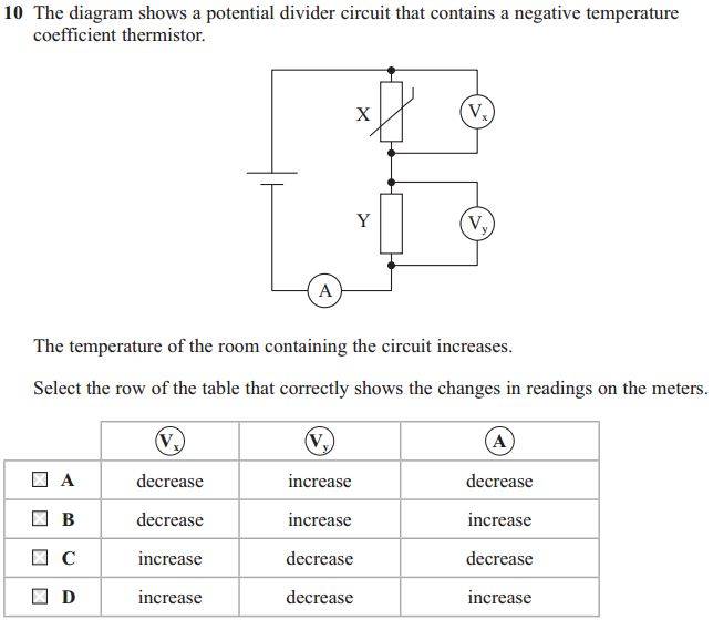

Circuit with NTC/Voltmeter/Ammeter
  • Thread starter ravsterphysics
  • Tags
    Circuit
The summary is: In summary, when the resistance of the NTC decreases, the total resistance of the circuit decreases, resulting in an increase in current. This leads to a decrease in the PD across X and an increase in the PD across Y.
ravsterphysics
57
Since resistance of the NTC falls we can say that the total resistance of the circuit has decreased so there is now more current in the circuit, so it's definitely answer B or D.
And since X's resistance has fallen, PD across X will decrease too (because even though current has increased, the drop in resistance is bigger than the increase in current??)
And since there is more current in the circuit, the pd of Y will increase??
Right.
Likes ravsterphysics
