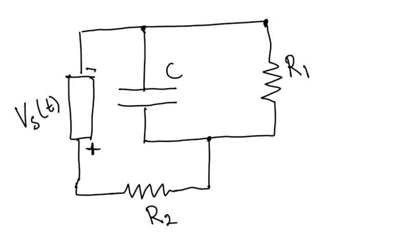

We have a circuit with a battery, two resistors, a switch and a capacitor. We assume that the battery has a switch so that we can choose whether it should be a voltage source for the circuit.
a) At time t = 0, we put on a voltage Vs
over the battery in the circuit. What is the current over the resistors and over the capacitor?
b) At time t = 0, we put on a voltage Vs
in the circuit. What is the charge on the capacitor as a function of time? What is the current over R2
I assume that the circle with the V inside is the switch. I guess I have to use
Kirchhoffs first and second law somehow, can someone give me hints? I not sure if understand the different components of the diagram, where is the switch for instance?

Usually a circle with a V inside represents a voltmeter. The switch would be associated with the Vs(t) component (the battery).
What have you learned about the basic RC circuit so far?
Not much, so there is no resistance in the voltmeter?
The voltmeter, unless stated otherwise, is considered to be ideal and does not affect the circuit at all. It effectively has infinite resistance (open circuit).
You'd best go to your class notes and textbook and look at the sections that describes capacitors and the RC circuit. There's a formula or two you'll need.

But "open circuit", does that mean that the circuit is equivalent with this image, see picture:
Yes.

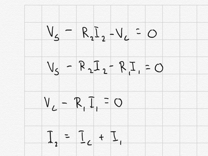

I found, using Kirchhoffs laws, the following: but I don't know how to go further
How do i find I (current) as function of time?

Let's re-draw the circuit so that it's in a more familiar layout:
Since there are no charged particles in the capacitor at t=0, I guess the voltage Vc would be zero.
But also, because Vc = Q/C = 0/C = 0
For the final voltage I guess;
Vs - I2R2 - Vc = 0
Vc = I2R2 - Vs
But also;
Vs - I2R2 - I1R1 = 0
Vs = I2R2 + I1R1
But because of Kirchhoffs current law, I1 = I2
Which gives
Vs = I2(R2 + R1)
Therefore
Vc = I2R2 - Vs = I2R2 - I2(R2 + R1) = I2R1
Vc = I2R1?
To determine what the final potential across the capacitor will be, remove the capacitor from the circuit (it draw no current anyways). Then look at what remains of the circuit. There will be no time-varying values anywhere in the circuit so you can treat it just as you would any resistor network being driven by a DC source. Determine the potential between the points where the capacitor was removed.
That would be the voltage over R1? Which is I2R1
Sure, but what is I2? You should be able to find these values using only the given component variable names, no introduced unknown values.
l2 = Vs/(R1+R2)
Giving
Vc = l2R1 = VsR1/(R1+R2)
Right! Now you have final "values" for the capacitor voltage and the currents i1 and i2.
Do the same for their initial values. To find initial values, take the capacitor voltage to be zero (replace the capacitor with a short circuit) and analyze the circuit.
I1 = 0
and
I2 = Vs/R2 ?
