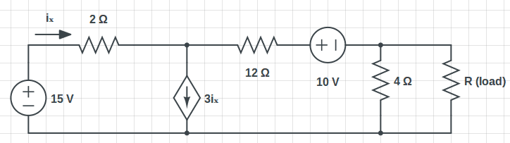

a. Find the Thevenin equivalent circuit across RL.
b. What is the value of RL for maximum power?
c. Calculate the maximum power that can be transferred to the resistor RL.
[strike]a. Rth=2.88 ohm
b. RL=2.88 ohm
c. P=154.3 mW[/strike]
Edit: looks like I found an error. Here is my second attempt:
a. Rth=2.933 ohm
b. RL=2.933 ohm
c. P=150.8 mW
I have a test upcoming and we were given this as a practice question. Unfortuantely, there is no answer so I don't know if I it is correct or not. Can anyone let me know if my answers are right? I used MultiSim to check the answers for my other practice questions and I found mistakes. I can't use MultiSim to check this one.
This is the other similar problem that I need to make sure I have done correctly: http://i.imgur.com/g2JaZXO.png
My answer: P=69.4 mW
Had you provided your working, someone may have looked over it to see whether the approach was right.
A Thévenin equivalent requires a voltage source and a resistance.
