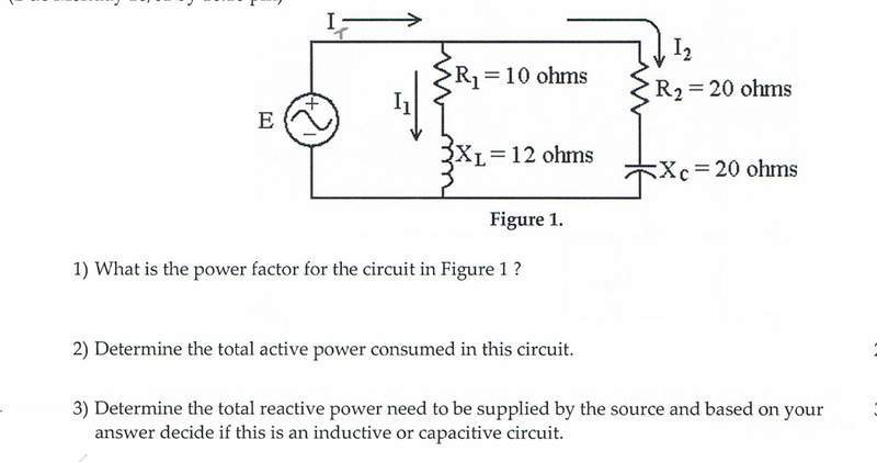

In summary, the total impedance is 14.23 ohms with an angle of 20.15, and the power factor is .938. While initially stuck on parts 2 and 3, it was later discovered that the supply voltage should be assumed to be 120v with an angle of 0. With this information, the power delivered can be calculated.
jhess1184
I found total impedance to be 14.23 ohms with an angle of 20.15. Found power factor to be .938
Pretty much stuck at a dead end trying part 2 and 3.
[STRIKE]Can you detail your calculation of impedance and power factor? 14.24 Ohms seems a bit small to me.[/STRIKE]
EDIT: Never mind, my mistake: you have the impedance correct.
What's the magnitude of the voltage supply, E?
Supply voltage or current was not given. Just found out we were supposed to assume a 120v with angle 0 supply.
Okay, so you known the voltage supplied and you know the impedance. You should be able to find the power delivered.
