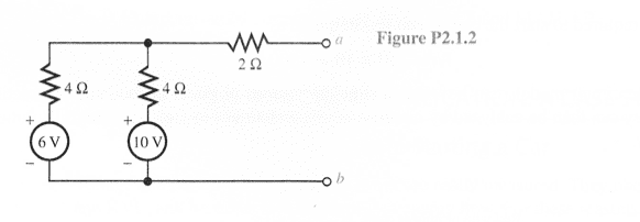

I am not getting this at all. I know that I need to calculate the open circuit voltage Voc and the short circuit current Isc. I really have no idea how to find Voc. There is some conceptual leap I need to make here. When the circuit is "open" across a-b, I know that no current flow through the 2 ohm resistor and this allows me to find the current flowing through the left loop (which is = 0.5 A ). But I have no idea how that helps me to find Voc = Vab which is outside of that loop.
You know the current so you can calculate the potential drop across the 4 ohm resistor connected in series with the 10 V battery. With respect to b, the potential is 10 V at the upper terminal of the battery. The current flows upward, so the potential drops across the 4 ohm resistor, but there is no change of potential across the 2 ohm resistor. So what is the potential at b?
Hello ehild :smile: I am confused as to why we do not consider the outer loop with the 6 V battery?
You did consider it when you calculated the current.
The potential at a can be calculated from any path between a and b. If you take the path that contains the 6 V battery, you have to add the voltage across the resistor as the current flows downward.

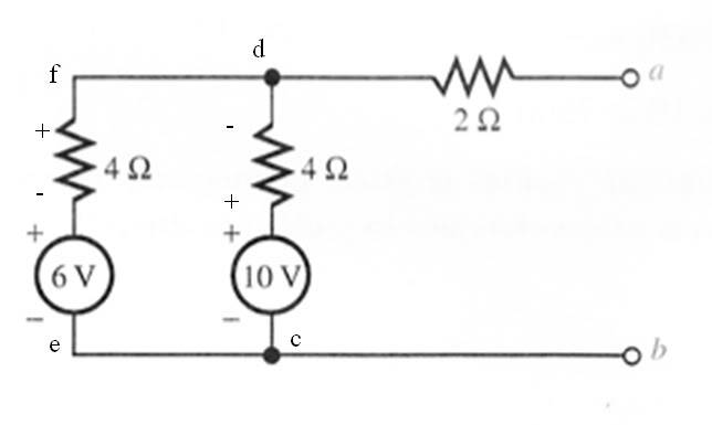

Hi again ehild. Thank you for you patience, this is not very intuitive for me. I have attached a new diagram in which I have drawn in the polarities and added some labels. Please tell me if this is correct:
1) The open circuit voltage is measured across ports a and b, which means I let b be my zero reference voltage and I measure the voltage at a with respect to b (or I could work from a to b).
2) To measure the voltage, I can step through either branch of the circuit: bcda or befa and algebraically sum the voltages.
So, for branch bcda we have: - 10V + 4Ω*0.5A = - 8V
And for branch befa we have: - 6V - 4Ω*0.5A = -8V
Is this good so far? If so, can we talk about the meaning of the signs? If we instead measured from a to b, we would have gotten positive 8V. Does this just tell me the direction of the current at the load resistor?
Going from c to d you're going UP 10V then DOWN I*4Ω = 2V . So the voltage at a should be positive 8V.
Hi gneill :smile: We have always gone with the following convention: As you pass through the loop and encounter an element, you assign it the first sign that you encounter. So as I go up through the 10V source, I encounter its (-) terminal first and hence assign it a (-) value. I guess it makes more sense to do the opposite since it gets you a positive value for a source.
But anyway, more importantly, my procedure is correct? I can use either branch to find Voc?
Now I also need to find the short circuit current Isc. I do this by "attaching" a wire from a to b and finding the equivalent current in the circuit. So I know how to combine resistances when there is a simple circuit with a single source and a bunch of resistors, but I am not so sure as to what to do when there are multiple sources? I feel like I need to combine them, but I am not sure how? Any suggestions on this?
Yes, you can use either branch to find the resulting output voltage.
If you are having trouble determining the short circuit current, then I can suggest a few ways to proceed. First, you could just use KVL loops for the two loops and solve for the current. Second, you could find the Thevenin equivalent of the circuit before the 2 Ohm resistor first; for that step you'd have a direct short across the legs and you'd just have the currents caused by each source through its own series resistor to sum up. Add the 2 Ohm resistor back in afterward; you'll have a single supply in series with its Thevenin resistance and the 2 Ohm resistor. Third, you could convert each source and resistor into its Norton equivalent to begin with, then combine into a single Norton equivalent. The short circuit current would then be given by the current through the 2 Ohm resistor as a parallel branch (Norton current splitting between the Norton resistance and the 2 Ohm resistance).

Ok then :smile: I will use the first method since I am in the process of learning about Thevenin and Norton equivalents and will hopefully reduce this circuit to both. But for now, I will use KVL (using my sign convention) :
KVL bcdab:
-10V + icd*4Ω + ida*2Ω = 0
KVL befa:
-6V - ief*4Ω + ida*2Ω = 0
And I am going to take a wild guess here that I need to use KCL to eliminate the 3rd unknown current.
KCL Node d:
ida=ief + icd
So I can each of the individual currents here, but how do I get Isc from this information?
Thanks again for your help!
Isc is just your ida.
I might've chosen the loops slightly differently so that one of the currents being solved for was the short circuit current. See figure attached.
Ok! So Isc is simply the current that flows through the "wire" that I attched in order to short the circuit!
So my Thevenin Equivalent circuit is simply a voltage source with a value of VTH = Voc that is in series with a resistor with a value of RTH = VTH/Ioc.
Correct? If so, I would like to move on to the Norton equivalent. All I need to do is use the fact that:
RTH = RNo
VTH = INoRNo.
So we have that
INo = VTH/RNo = VTH/RTH
and it looks from all this that my short circuit current is the norton equivalent current Isc.
So really, there is no additional work required to find the Norton equivalent? I simply replace the circuit with a current source whose value is INo=Isc that is in parallel with a resistor whose value is RNo = RTH.
Correct?
Correct.
