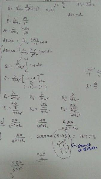

The figure above shows three circular arcs centered on the origin of a coordinate system. On each arc, the uniformly distributed charge is given in terms of Q= 2*10-6C. The radii are given in terms of R = 10cm. What is the magnitude of the net electric field at the origin due to the arcs?
dE = Kλds / r2
ds=rdθ
λ= Charge / Length ⇒ Q/2πr ⇒ Q/(2πr/4) - since only quarter is shown ⇒ 2Q/(πr)
So i think I got all the steps correct except i can't figure out why i have to multiply sin(45) to get to the right answer at the end.
1. dE = Kλds / r2 - used this formula b/c it's a ring
2. dEcosθ = Kλds / r2 (cosθ) - multiplied cosθ b/c perpendicular component (sinθ) cancels each other.
3. dEcosθ = Kλrdθ / r2 (cosθ) - replaced ds to rdθ b/c cosθ is present and thus want to integrate along 90° to 180°
4. ∫dEcosθ = ∫Kλrdθ / r2 (cosθ) ⇒ E = Kλ/r ∫(cosθ)dθ - r on the numerator and r2 on the denominator cancels to make denominator just r. since r is constant, took out of the integral and just integrate cosθdθ from 90° to 180°
5. E = Kλ/r [-sin(180°)-(-sin(90°)] ⇒ E = Kλ/r - integral just turns out to be 1 and we are left with E = Kλ/r

You lost me at step 2, multiplying by cos theta. There is a valid method which does that, but does not relate to the explanation you offer. The corrsponding sin case does not cancel out (and that's where your root-2 factor would come from). Please elaborate on your explanation there.

Yes, I pictured the arc along the axis so the corresponding cos theta would all line up and sin theta would cancel b/c i didnt know how to incorporate cos45 and sin45 into components and calcuate it separately.
So i don't know if you guys can ready my terrible handwriting but here is what i worked on and at the last step i don't know why i had to multiply sin45 to get to the correct answer.

Maybe you need to clarify your axes. If they are the obvious ones according to the original diagram, the sines do not cancel. If you are taking the axes at 45 degrees, so that the arcs are symmetric about the x axis, the the sines do cancel, but the integration range for the angle changes (and is not what you used).

I'm still unsure what axes you were using in your first attempt. Please clarify. What do you mean by "line up with axis"?
Yes, if you take the standard axes according to the picture, so that theta runs from 90 to 180, that is the vector form of field you need to integrate.
But, as I posted, you could just as well choose to rotate the axes 45 degrees so that you know one of the axes will have no net field. The range for theta then changes (and produces the missing sqrt(2) factor).

on the first attempt I was tilting axis about 45 degrees so it sine would cancel.
and "line up with axis" on the comment where I separated into components, I tried solving it like the standard problem given
the attached picture on the comment, however, i tried to solve it by moving the all three arcs with their center lined up with x-axis.
so if i did titled the axis about 45 degrees and solved this problem, the range of integration would change to 45 and 135? since you are tilting to the right 45° thus
90°-45° = 45° and 180°-45° = 135°

Yes, try that integration range.

Oh my gosh! I can't believe it! Thank you so much for your guidance! I finally figured it out. Physics starting to make sense now!
