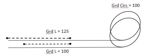

Consider a train of proper length 100 at rest in an inertial ground frame. It is accelerated Born rigidly to the right on a straight track to 0.6c in the ground frame, after which is still has proper length 100 but has now ground length 80. It is then shunted onto a circular track of ground circumference 80. The front grazes the rear as the front exits the circle and returns to moving inertially to the right in the lab frame.
Is this just a circular version of the barn/pole paradox? The entire train is in the 80 circumference circle simultaneously in the ground frame. It seems consistent with Einstein's view of the circumference in the Ehrenfest paradox. On the other hand, if I analyze it from the train frame, an issue arises.
Say I treat the front as if it were momentarily at rest in a series of co-moving inertial frames (as if the circle were an polygon, with inertial frames parallel to the sides of the polygon). When the front changes direction to be at rest in the co-moving frame parallel to the first side of the polygon, the front undergoes infinite acceleration at a slight angle relative to the rest of the train. This should cause the train to deform (the front should stretch out away from the train) as in Bell's spaceship paradox. That is, the train does not just deform in the simple sense of bending. It also stretches out, as in Bell's paradox.
Would this occur? Or, by making the sides of the polygon smaller and more numerous could I reduce the stretching continually until in an actual circle there would be no stretching, so that the train would not be deformed? Then the scenario should be a circular version of the barn/pole paradox.

The consensus seems to be that the train fits into the 80 ground circumference circle without being deformed -- other than the non-relativistic bending caused by following the curved track.
So the scenario is like the barn/pole paradox in the inertial ground frame. But it is not like the barn/pole paradox in two other ways: (a) the resolution does not depend on the relativity of simultaneity, because there is no shared simultaneity for the parts of the train that are within the circle, and (b) there is no equivalent for the train of the fact that in the pole's reference frame the barn is length contracted.
Here is another hopefully clearer explanation of my concern about whether there might be some relativistic deformation as the train enters the circle (some deformation other than the non-relativistic bending). When the front of the train enters the circle, the rest of the train behind it is still moving to the right inertially. So by the "train frame" I meant the inertial frame in which the remainder of the train is at rest. Alternatively, one can say the inertial reference frame moving to the right at 0.6c that is co-moving with the rest of the train.
So in that inertial frame in which all parts of the train other than the front are at rest, the front of the train undergoes acceleration and moves away at the angle of the first side of the polygon.

I developed the scenario while grappling with that faq and the note at the end. The basic idea is to avoid the thorny question of what happens when you take a circular object from rest into rotation (what shear forces might exist, etc.), while not giving up on identifying how the object came to be in rotation (which seems to me still to have some relevance, particularly when you can use straight line motion to start the analysis, because I find that easier to understand). Thus the set up using Born rigid acceleration first, followed by entry into the circular section of track.

Another approach, though, is to consider how a single observer on the train measures the length of the circle. I revert to a polygon in part because of the argument that if you use an n-gon, the observer will find each side to be length contracted by gamma (just like the astronaut who travels to Andromeda, or a muon that travels downward past a mountain), and therefore the entire circumference to be its ground length contracted by gamma. See http://abacus.bates.edu/~msemon/WortelMalinSemon.pdf , page 1125.
This results in a circumference for a train observer in our scenario of 64 rather than the Born coordinates' of 80, and rather than Bini and Jantzen's (and Einstein's) view that for the rotating observer the circumference is a Lorentz expanded 100. This may well be misleading (see more below).
In any event, I appreciate the discussion very much. It is helping me to understand that coordinates are not necessarily critical to understanding what happens to the train, and also to understand the concept that coordinates do not have to have an immediate metrical meaning.
Say the train is very brittle, just able to handle the bending that results from going around the circle, but no more deformation without shattering. If it is accelerated Born rigidly along the straight section of track by many rockets arrayed along its length then it does not shatter. If instead the rockets accelerate all of its parts at the same rate in the ground frame along the straight track, it will shatter (the rockets will pull it apart all along its length). Whether the train shatters or not is invariant in all frames.
Now assume that the brittle train is accelerated Born rigidly in the straight section of track, then enters the circle (say it even stays in the circle as A.T. postulates). I think that everyone would agree that the train does not shatter. It does not shatter during the Born rigid acceleration because the rockets accelerate all parts in a way that maintains their combined proper length. It does not shatter going into or remaining in the circle because . . . here I am less sure of how to describe the why. One way of putting it is that using the radar method, its length is still 100.
So coordinates are not necessary to understand what happens to the train: it does not matter that we cannot come up with coordinates that give the train a length of 100 while rotating, or that the parts of the train are not at rest in an inertial frame. Also, the coordinates we can identify "may be misleading": if I focus on the Born coordinate length of 80, or the conclusion that a single observer would measure the circumference to be 64, I might be led to conclude that the brittle train has compressed to 80 or 64 within the circular section of track and therefore shattered. But again, I don't think that anyone would conclude that the brittle train shatters.

JVNY said:
Some people argue that if you cannot globally synchronize clocks then there cannot be a well defined length:
I would rather say: Without globally synchronized clocks, you cannot use the most gereneral defintion of length, which is also applicable to moving objects. But if your object is static then you don't have to care about synchronized clocks. Also as you note, a length based on synchronized clocks depends on the synchronization convention chosen, so it's always ambiguous.
JVNY said:
See pages 6-7 here: http://areeweb.polito.it/ricerca/relgrav/solciclos/tartaglia_d.pdf. However, note that the author (Tartaglia) thinks that the Lorentz expanded result is a function of forces that affect the mirror, not a reflection (no pun intended) of the length of the circumference.
Peter Donis said:
Where does he say that? I agree with the three conclusions he draws
Ditto. I agree with the three conclusions at the end of Tartaglia's article, but I haven't located the section that JVNY is talking about.
PeterDonis said:
Please define exactly what "length" you are computing. Ideally, I would like to see what spacelike curve it corresponds to in Born coordinates. The spacelike curve I gave (##t, r, z## constant, ##0 \le \varphi \lt 2 \pi##) has a length of 80, as I've already shown.
The curve I would describe as the length most natrually lies in the quotient space, also called "the Relative Space", a paper using this approach is http://arxiv.org/abs/gr-qc/0309020 "The Relative Space: Space Measurements on a Rotating Platform".
Ruggerio said:
We introduce here the concept of relative space, an extended 3-space which is recognized as the only space having an operational meaning in th study of the space geometry of a rotating disk.
However, one can also think of it as a curve in space-time, it is, however, not a closed curve. On the diagram below (borrowed from wiki):
https://upload.wikimedia.org/wikipedia/en/3/31/Langevin_Frame_Cyl_Desynchronization.png
The curve is a blue helix on the diagram. It starts where the blue helix intersects the red worldline of an observer with constant coordinates in the Born chart (referred to by several people in this thread as "at rest in the rotating frame", and ends where it intersects the same worldline.
The "Relative Space" approach defines an abstract quotient space (which however has an operational meaning as Ruggiero points out) by identifying all points on the worldline of an observer "at rest" in the rotating frame (i.e. an observer with constant Born coordinates) as being a single point in the abstract quotient space. The distance between points in the abstract quotient space is well defined and is equal to the length of the curve that is everywhere orthogonal to the worldlines of the "at rest" observers.
Please note the key word "nearby". I am not disputing that nearby measurements of length, using the methods you describe, give a "proper length" between nearby observers on the train which, if added up around the entire circumference of the train, would sum to 100. I am only disputing the adding up process, not the individual pieces. The adding up process does not make physical sense, because you are adding up a large number of spacelike line elements that are not collinear; they each lie in a different spacelike hypersurface. So calling the sum a "length" is, IMO, an abuse of terminology; it is not a physical "length" in any meaningful sense.
While I would agree that one is adding up a large number of spacelike segments (performing an integration, in other words), I would dispute the claim that it does not make "physical sense". We know how to measure distances on the rotating platform operationally, all we need to do is add them together. In short, given that we know how to find the distance between nearby points, we know how to find the distance of points that are further away by performing an integral.
Physically, if we attempt to put short measuring rods (which we've agreed we know how to determine the length of) around the circle, we can only fit so many before they start to overlap. They overlap when the spatial parts of their Born coordinates overlap. The number of rulers we can place this way multipled by the length of each of the rulers gives the circumference.
I would even suggest, that it's the most physical way to determine the length. Because it corresponds to physically laying out rulers at rest, and doesn't depend on some convention of clock synchronization.
In the Tartaglia article see the last paragraph of page 6 for the description of the clock unit measurement method and the formula describing the resulting Lorentz expanded length of the circumference.
Then see the first sentence of page 7 for the result of that measurement and formula: "The induced length would then be greater than for a static disk and in contradiction with the direct measurement."
Then lines 5-6 of page 7 for the conclusion that centrifugal forces "actually influence the mirrors, not the light as such, since no real gravitational field is present."
Finally, the 4 lines on page 7 just before the header for section 4.1, where he punts on the contradiction between the radar measurement and what he believes to be the direct measurement:
What should the observer conclude with respect to the length of the rim? May be he would guess there is something with the clock and the global time measurement or simply that his reference frame is not inertial and in particular that it is steadily rotating.​
You can analyze the radar method from the ground frame. The clock unit is affixed to the train, which is rotating in the circular track of ground circumference 80. A first light flash trip, co-rotating with the train, closes the 80 distance at a ground speed of 1 - v, or 0.4, so it takes ground time 80 / 0.4 = 200 to strike and reflect off of the clock unit. Then the return counter-rotating trip closes the 80 distance at a ground speed of 1 + v, or 1.6, so the return to the clock unit takes ground time 80 / 1.6 = 50. The total time for both trips is 250. Half is 125. Dilate that ground time by gamma = 1.25, and half the total time elapsed on the clock unit is 100.
For the group -- does anyone think that the brittle train shatters when it goes into the circle? This seems to me the fundamental question. Regardless of coordinates that you use, does anything happen to the train other than bending around the curve?
It's also not a spacelike curve, at least not when considered globally. Locally, the tangent vectors to the curve are spacelike, but there are points on the curve which are not spacelike separated. Any curve which is a valid "curve of simultaneity" must satisfy both conditions, not just the first.
But what curve are you integrating around? If it's the non-closed curve described in the quote above, this curve is not a valid "curve of simultaneity", as I noted.
Ultimately, though, this is a matter of interpretation, not physics. We will all agree on the results of any actual measurement; we just disagree on what ordinary language words to use to describe them.

Here is one last follow up about the train. Say the train of 100 proper length starts at rest on a circular track of 100 circumference in the inertial ground frame. The front and rear of the train are touching, but not attached to each other. Is it possible to Born rigidly accelerate the train within the circular track? I think that it should be. The train can use the same acceleration program that it used on the straight section of track because proper acceleration is an invariant. So the train should accelerate Born rigidly (retain its 100 length) while length contracting in the ground frame (even though none of the parts of the train share a simultaneity surface because the train is traveling in a circle). In this case the train would not occupy the entire circular track because it would length contract to less than 100 length in the ground frame.
  • #34
No. Born rigid acceleration is only possible in a straight line, not in a circle.
"Invariant" just means the proper acceleration of a given point on the train has the same value in all frames. It does not mean that the proper acceleration of different points on the train will be the same, much less that the proper acceleration if it is in a straight line will be the same as if it is in a circle.
  • #35
Agreed. However, I am proposing that the proper acceleration at each point on the train is different, with the greatest proper acceleration at the rear, and lowest at the front. Assume that the train is driven by a large number of small rockets arrayed along its length, with the thrust of each governed by an accelerometer. The thrust programs are set when the train is in a straight stretch of track, and the train does several trials and confirms that the thrust programs generate the correct thrust for each part of the train to Born rigidly accelerate it in a straight line. Next the train moves into the circular section of track and comes to rest there. It then activates the same thrust programs -- so the rear gets the most thrust and proper acceleration, and the remaining parts of the train ahead of it lower proper acceleration (with the front getting the lowest proper acceleration).
In the inertial ground frame, the train length contracts exactly the same as it does in straight line acceleration (the rear has greater ground speed than the front). Are you stating that the train compresses along its length (so that it shatters if it is the brittle type of train that I describe above)? Or that the train stretches out along its length (so that it shatters)?
Say you are going to ride on the train and you take along some fencing to erect along its length after it accelerates and settles into constant speed of 0.6c. Per A.T.:
A.T. said:
How much fence would you order
I think that you would order 100 of fence.
