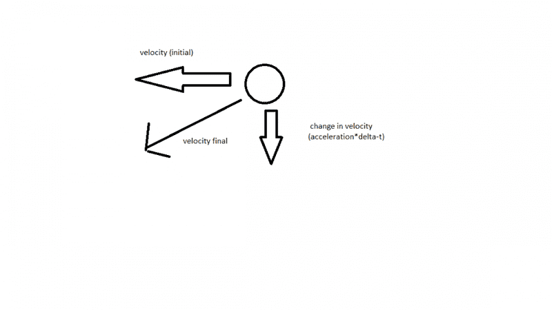

Yes, I completely agree with you in that the speed of the rock is fixed in uniform circular motion. I also agree with you in that acceleration is only causing a change in the direction only of the velocity. However, I still do not understand why, at any instant, the acceleration should cause only a change in direction. Please take a look at the attached image. In it, vf = sqrt(vi^2 + (delta-v)^2). As delta-t approaches 0 (but is still not 0), vf approaches vi (delta-v = a*delta-t), but is still not exactly equal to vi. This difference may be small, but over a enormous period of time, shouldn't the difference between vf and vi add up, and become significant enough to be observed?
*vi = initial speed
vf = final speed
delta-t = change in time
delta-v = change in speed

Prannu said:
...at any instant... delta-t approaches 0 (but is still not 0)
An "instant" has zero duration.
to clarfy the concept you can draw a vector diagram of the stone say at time t and a later time t+ dt-
say its at point A initially and after lapse of time dt it has moved to B -both A and B are on the circular path and draw now two tangents at A and B designating the velocity vectors at t and t+dt
let it be v1 and v2 naturally their directions will be making an angle theta with each other -the same angle made by the two radii at A and B.
Now you have to find change in velocity- so draw the two vectors at angle theta separately and the tip of v1 and v2 will be joined depicting the change in velocity in time interval dt say dv -you can apply triangle rule for the three vectors v1 ,v2 and dv - v1+dv=v2 so dv is along AB
now dv/dt is the acceleration and taking limit to dt tending to zero will give you acceleration vector. the magnitude of the third vector dv is radius times theta- but the direction of the acceleration will move towards the centre as dt tends to zero-
so you can see that the centripetal acceleration drives the stone on a circular arc but its speed does not change if the force is constant -the acceleration will come to v^2/radius.

A slightly different take on the error... The diagram as shown is biased. It is not time-symmetric. It takes the current direction of the acceleration as a given and extrapolates into the future on the assumption that the acceleration stays constant at its starting value. But it would be equally reasonable to extrapolate into the future based on the assumption that the acceleration stays constant at its ending value.
An approximation that uses the starting acceleration vector over a finite interval predicts in a small increase in velocity. An approximation that uses the ending acceleration vector over a finite interval predicts in a small decrease in velocity. The truth lies somewhere in the middle.
The smaller you make the intervals, the smaller the gap within which the truth can hide. As the intervals shrink toward zero width, the only place that the truth can hide is exactly at zero.

yes thank you for pointing out the error pranu is making -its a conceptual error of 'rate of change' depiction by differential -one has to go to the limits of dt tending to zero.

Oh, I see now. I was making a mistake in approximating the time interval: it was too large, which is why the speed changed also. Because dt approaches an infinitesimally small value, the delta-v has 0 contribution towards the speed, and therefore, the speed is constant. However, this dv (or dv/dt) is enough for the particle's velocity to change in direction only.
Thank you all for helping me clarify this problem!
