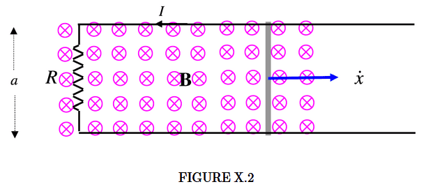

It can cause linear motion/acceleration if there are mechanical constraints on the motion of the metal rod or projectile.
Are you familiar with calculating the motion of a metal rod sitting on top of metal rails as part of a conducting loop?
https://phys.libretexts.org/Bookshe...ectromagnetic_Induction_and_the_Lorentz_Force
Likes PeroK and renormalize

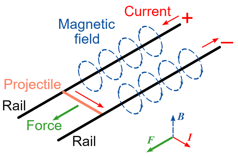

akansh_karthik_1 said:
how do devices like railguns accelerate their shells linearly?
The velocity ##\boldsymbol{v}## of the electrons in the current ##\boldsymbol{I}## through the projectile, crossed into the magnetic field ##\boldsymbol{B}## around the rails, results in a linear force ##\boldsymbol{F}## on the projectile that's parallel to the direction of the rails:
(from https://en.wikipedia.org/wiki/Railgun)
Likes PeroK and berkeman
That makes a lot more sense. Thank you everyone!
