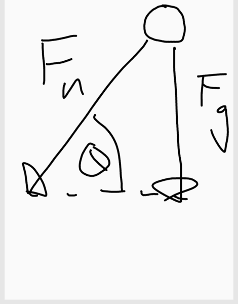

This question is referring to the classic ball in a loop question where it is dropped from a height and slides into a loop de loop.
Derive an expression in terms of theta the velocity of the ball at the time it loses contact with the track. Theta is measured from the horizontal at the height of the radius (Like the unit circle). And I am deeply struggling with this explanation
The ball will leave the rail when the rail reaction is zero. This happens when the centripetal force needed to travel around the loop is totally supplied by the component of the gravity force directed towards the centre of the motion.
I'm fine with the concept of working out the minimal velocity it needs so that the ball doesn't loose contact with the track v = sqrt(rg) because Fc and Fg are acting in the same direction
however how is the Fg acting along the radial part? It makes no sense to me as gravity should only act downwards in one direction not towards the center of the circle
mg*sin(theta) = mv2/r - this is the equation I am struggling with, why is sin(theta) on the mg side
My reasoning is that Fn vertical component when equal to Fg will start to fall, so if i draw a vector diagram and take out the vertical component of Fc/Fn
(mv2/r) * sin(theta) = mg
Can someone point out the fatal flaw in my intuition?

Pochen Liu said:
My reasoning is that Fn vertical component when equal to Fg will start to fall ...
The ball will lose contact with the track when the normal force Fn becomes zero. The track can communicate to the ball that it's there only through the normal force.
But how do we derive the part 'mg * sin(theta)' as normal force?
You need to derive an expression for the normal force at some angle θ and see under what conditions Fn = 0. Draw a free body diagram.

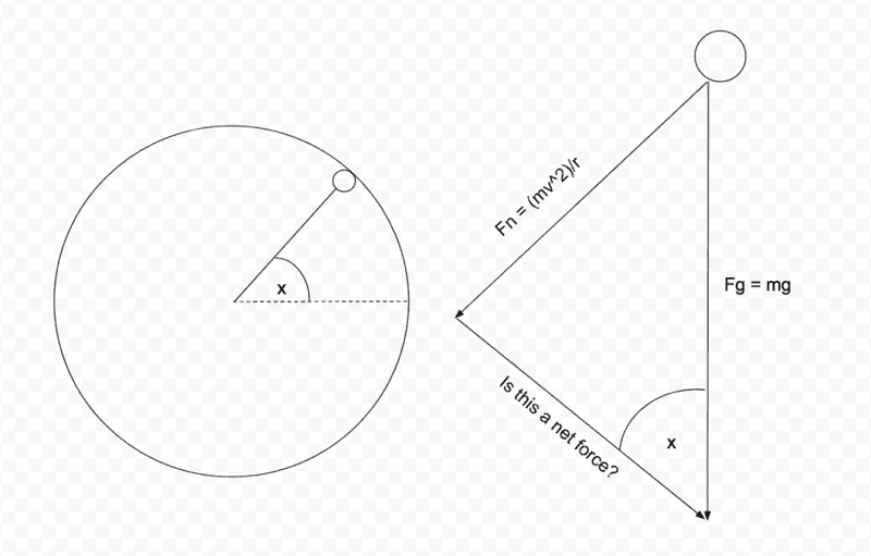

Is this the correct diagram? (The question I am doing refers to theta from the horizontal btw)
If so, I don't understand why it is drawn like this, as in what is that 3rd vector I have labelled
I have drawn this diagram purely because I know this is the only way I can get mgsin(theta) to be along the radial direction
And in the second diagram as the ball moves towards the top of the circle theta gets smaller, but as the ball moves towards the top of the circle theta actually gets bigger.
I don't understand!
It would be the correct diagram if you omit the arrow that connects the tips of the normal force Fn and the weight Fg. That arrow does not represent the net force and, besides, the net force does not belong in a free body diagram. You are interested in the angle between Fn and Fg. How is it related to the angle x above the horizontal? Hint: In the diagram on the left draw a perpendicular line from the object to the horizontal dotted line. That gives you a right triangle.

When I do that, I get this equation if I try relate x to Fc. I get this equation! Which was what I originally got and started my confusion
(mv^2/r)sin(theta) = mg
Can you show me how you get this equation from the free body diagram? What is the component of the net force in the radial direction? What is that component equal to? Your expression in #7 does not have Fn in it.
