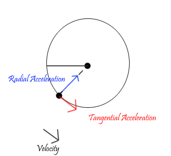

Diagram and Free-Body Diagram:
I don't understand how you would have used F = mv2/r to find the speed. Use energy to find the speed, then use that equation to find the tension.

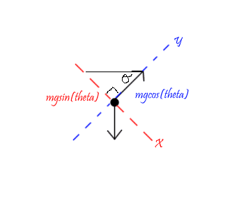

I'm trying to use Fnet = mv^2/r. The net force in the x direction is mgCosθ and the net force in the y direction is T - mgSinθ.
That's true if y is radial and x tangential. But in that case vy = 0.
This is how I have it set up:
From this, how do I set up my equation to find the tension without breaking it into components?

OK, that's what I deduced from your force equation. But notice that with these coordinates, at a given instant, the velocity is entirely in the x direction. T - mg sin(θ) = mv2/L. I should also have pointed out that you keep writing Fnet = mv2/L. That would be true if v were constant magnitude, but there is also tangential acceleration here. So you should write Fnety = mv2/L.
Ohhh, okay. That makes sense now. Since there is no velocity at any point in the path, that would mean there is also no acceleration, so:
No! At a given instant, the velocity is in the tangential (x) direction, but that direction keeps changing. There is acceleration in both the tangential direction (the speed increases) and the radial direction (centripetal).
Use the expression you have for v from considering energy.
Okay, that clarifies things after making a visualization of the situation.

I was just looking over my work, and I noticed that I didn't quite understand why you said T - mgsinθ was the net force in the Y direction.
If my axis was horizontal and vertical, it would be Tsinθ - mg, but I had set my axis is along the path of motion.
I'm confused how you got your angle... Could you clarify the reasoning behind this?
Also, as question on the side: If I had used the horizontal and vertical axis, would I just find the tensionx and tensiony and take the pythagorean theorm to find the tension?
Unusually,theta is the angle to the horizontal, not the vertical. So the component of mg in the radial direction is mg sin theta. The component of T in that direction is T. T acts in the direction of the centripetal acceleration, while g acts the other way.
Okay, that makes sense.
