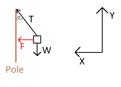

I tried googling and searching around, and found this scheme:
https://www.physicsforums.com/attachments/diagram-jpg.4312/
So, from that diagram, F (centripetal force) is also part of that triangle (not sure how that triangle is built though; I guess it comes from the scheme of all the forces, the free-body drawing thing). Therefore from geometry it should be equal to N*sin α
N in its turn should be mg/cos α
So F = mg*sin (α)/cos (α) => F = mg*tan α
From there, F = F =>
m*ω2*r = mg*tan (α)
ω2*r = g*tan (α)
ω = [...]
Tried putting the numbers in there, but the result for T is wrong (not even close).
For the record, I also tried forcing the friction force in there somehow. Assuming that it's got something to do with the horizontal movement, I tried adding or subtracting it (assuming Friction Force = m*g*cosα) to the Centripetal Force. Neither random guess seemed to work.
So...how is this supposed to be done?

Draw a free body diagram of the forces acting on the suitcase as it rotates at an angle to the horizontal along the belt. Sum force coordinate componets to zero. (I recommend cylindrical coordinates).

Whew! A lot of writing and conjecturing! Which is great - shows you are very immersed in this problem!
First, I just want to mention that you should have been introduced to cylindrical coordinates by now. But OK, turns out this problem can be handled with xyz (cartesian) coordinates equally easily.
I suggest you start your analysis by assuming zero rotation rate, then you can modify the equations to include rotation.
You drew a very good free-body diagram! Except you left out the friction force which always acts so as to deter slippage. So draw this force in, acting on the bag along the slope in an upward direction (since it wants to slip down, right?) Call it F. So there are F, N and W forces. F and N have x and y components; W just a y component.
So sum forces in the x and y direction to zero (2 equations) since the bag is at rest. You can now solve for F and N.
Other thing to keep in mind is that F depends on other, external forces. If α = 0, F = 0. If α > 0, F will be finite. But there is a limit on how high F can be before slippage occurs. After that, F actually decreases (now called dynamic instead of static friction).
So now you modify one of your equations by adding the centripetal force acting to slide the bag. Since this extra force acts towards the center of rotation it should be obvious which of your two equations needs to be modified. So now solve again for F and N.
Finally, to find the point of slippage in terms of rotation rate, make use of the point I raised about F depending on other forces, and that it can only be so high.
Enjoy!

Your problem is that you are being inconsistent with signs.
You have drawn the friction force as being down the slope. Although that is wrong, it should not matter. It only means that a negative value for the coefficient will come out of the equations. What does matter is that you use it consistently.
Remember that the centripetal force is not an applied force; it is a resultant force. Your horizontal force balance equation above is as though it is an applied force balancing the outward component of the frictional force. Given that you are taking the frictional force as acting down the slope, your equation should be N*sin(α) + μ*N*cos(α) = -Fc.

1. If I take a "spherical", closed bucket (figure on the right is supposed to represent a sphere seen from the side), then I can see that Nx is minimum (zero) "at 6 and 12 o'clock" (top and bottom), whereas it's maximum "at 3 and 9 o'clock", which would be in its middle, where the horizontal-cross-section-radius is maximum (its "equator", so to speak). So this would seem to justify what I assumed a moment ago.
2. If I take a "conic" bucket (upside-down cone, with its apex at the bottom, and its base at the top), when I try to draw the N vectors they all seem to be parallel since the "side" of the cone (or at least the sides of the triangle-section of a cone) are not "bent" like in the sphere case, but instead they are "straight", so their angle with the horizontal line is always the same. Maybe I'm just drawing it badly, but they seem to have the same angle, so same Nx, no?
Regardless of this, three more things came to mind:
1. Does this mean that, with a closed spherical container, if I keep accelerating the object will actually stop going up once it reaches the "equator" ? In other words, it doesn't actually want to go up per-se, it just wants to go to a bigger radius, which is "up" until the equator, but then that's its "best" spot? Or does the object keep rising past the equator if we increase the force even further?
2. Surely the Normal force Nx has to have a "cap" at one point. On the contrary, centripetal force can be increased "infinitely". What happens once we get to the point where Nx is maximum but we continue to increase the centripetal force? Does the object lift off the surface of the bucket, and "flies off"? For example, if what I think is right and in the sphere-bucket case the maximum Nx is at the equator, let's say that the object is currently on the left side of the bucket and we increase centripetal force beyond the point of Nx's ability to compensate. Does the object fly off from left to right now? If so, what path does it take? If I had to guess I would say it's a straight path to the middle, i.e. aligned with the centripetal-acceleration vector.
3. The fact that Nx points to the middle already means that even with a theoretical frictionless bucket we could still do circular motion inside of it, and the object wouldn't fly off. With friction, however, the "maximum centripetal force" we can apply before the object flies off the surface (what I mentioned in the previous point, assuming that's what happens) is higher, because we have friction helping poor Nx keeping the object on the surface. Is that it?
I'll continue with the rest in another post :D
Meanwhile, thanks for bearing with me so far guys, I think I'm slowly getting this.
