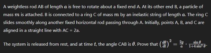

weightless rod AB of length a is free to rotate about a fixed end A. At its other end B, a particle of mass m is attached. B is connected to a ring C of mass m by an inelastic string of length a. The ring C slides smoothly along another fixed horizontal rod passing through A. Initially, points A, B, and C are aligned in a straight line with AC = 2a
The system is released from rest, and at time t, the angle CAB is θ.
(d/dt (theta)) ^ 2 = (2g)/a * (sin theta)/(1 + 4sin^2 theta)
I used law of conservation of energy to calculate (d theta/ dt)^2 (from:mgasin theta=1/2m(d theta/dt.a)^2+1/2mu^2(u is the velocity of the C ring at time=t)), but wasnt able to find u(velocity of C).Is there any relationship between the tangential velocity of B(d theta/dt.a) and velocity of C(u) that I'm missing?

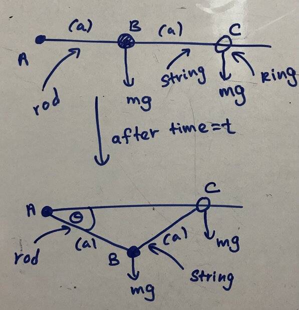

This is how I think It should look like.
Thank you for the drawing.
What are you asked to find? It is not clear from the statement of the problem.
Also, the drawing shows that the rod "after time = t" is horizontal. The statement of the problem says that the "weightless rod AB of length a is free to rotate about a fixed end A." Both cannot be correct. If the rod is free to rotate, it should be at some angle below the horizontal after some time has elapsed.
There are two rods. C slides on a fixed, horizontal rod of unspecified length. Particle B is at the end of a massless rod that is free to rotate in a vertical plane about A. Initially, this rod is horizontal so that the ring C is a distance 2a from A.

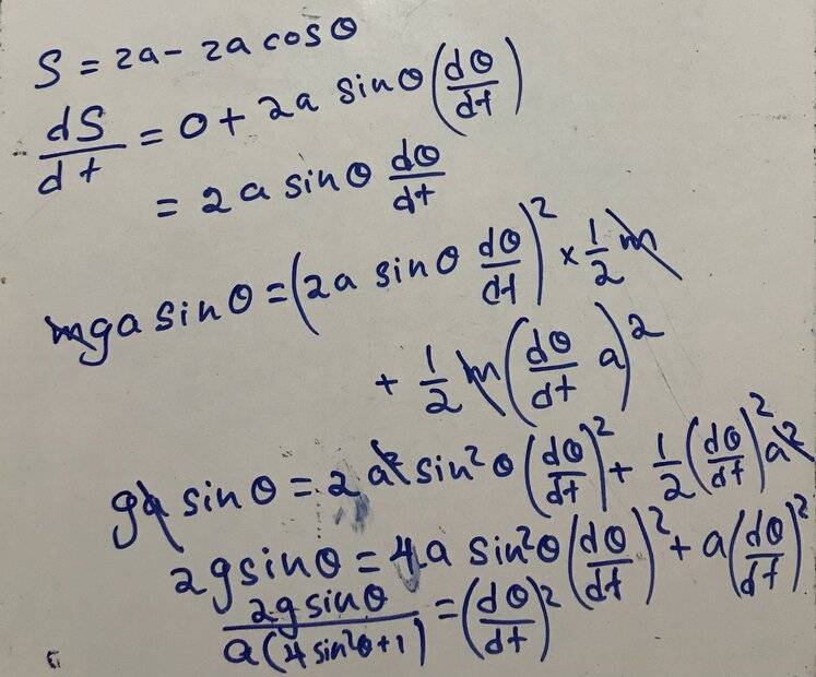

Let ##x## be the distance of C from A. Can you express ##x## in terms of ##a## and ##\theta##?

2a cos theta?

2a cos theta?
Yes. Can you use this to get the relationship between the speeds of B and C?

How do you get velocity from position?

first derivative?
PitViper said:
first derivative?
Oh my god dude I got it

This is it right?
