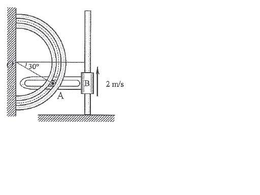

As block B moves upward with constant speed 2 m/s, pin A glides through the semicircular slot. At the position shown, determine the velocity of A.
a. 2.31, angle 60o
b. 2.00, angle 60o
c. 1.00, angle 0o
d. 1.89, angle 30o
Not sure
A and B will have the same speed, so the answer is b (the angle is 60o to the horizontal) ?
Thanks
The velocity vector of A is going to be tangent to the circle, so its angle relative to the horizontal will be 60 degrees (you can check this with some simple geometry). We also know that the vertical compontent of this vector is 2 since it is given by object B. By pythagoras the magnitude of the vector must be greater than 2. Therefore, the answer must be (a).

Oh I get it. Thanks a lot Vykan12 :smile:
