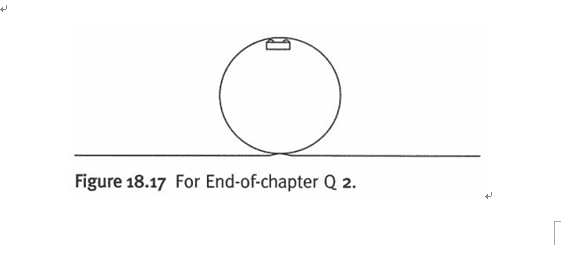

I am trying to study Circular Motion for my exams and I'm kind of unsure about one question. The question asks what's keeping the truck in circular motion. It has to be gravity I know, but gravity being directed towards the center, shouldn't that just result in the truck falling? What keeps it INTACT to the track? I am giong to quote the actual question now.
"Figure 18.17 shows part of the track of a roller-coaster ride in which a truck loops the loop. When the truck is at the position shown there is no reaction force between the wheels of the truck and the track. The diameter of the loop in the track is 8.0 m.
a) Explain what provides the centripetal force to keep the truck moving in a circle.
b) Given that the acceleration due to gravity g is 9.8 m s-2, calculate the speed of the truck.
Why gravity?
What keeps the truck moving in a circle when it's at the 3 o'clock or 9 o'clock position? What about at the 5 and 7 o'clock positions? What other force(s) are acting on the truck - in particular, pushing it towards the centre of the circle (which is what centripetal means)?

It is gravity and, as you conclude, at this point (for an instant) the truck is in free fall. To see what's happening, imagine the track was only the right half of the loop, so that after the highest point, there is no track to the left. What would happen to the truck?
Hint: look at question b). Note that question b) refers to the speed of the truck at the highest point.

Inertia is not a force. The truck won't go straight for a while, it will fall in a parabola. Try drawing parabolas for the truck:
a) If it's still moving fast at the top of the loop.
b) If it's moving "too slowly" at the top of the loop.
We're still imagining there is no track on the left here, so the truck is falling through the air.
Centripetal force is the net force. What two forces sum to make it? Try drawing a free body diagram to the car.

You're over-thinking this a little. If, at the top of the loop, the truck has sufficient speed, then it will fly off in a parabola outside where the circular track would be. So, when you add the track, the truck is forced into the circular path.
If, however, the truck is moving too slowly, the parabola will lie inside the circle. In which case, when you add the track, the truck will leave the track until at some point it crashes back into it.
That's one explanantion why there is a minimum speed required at the highest point. If the truck isn't moving fast enough, then it does fall off the track.

Okay, forget parabolas for a minute.
The truck sticks to the track because of the normal force; in space, the normal force would only be created by the truck running into the curvature and getting squished into the track with a centripetal acceleration ##a=v^2/r##. Give the slightest push to the truck and it will go 'round and 'round the track forever. But, it's not an orbit in the sense of gravitational pull, as you point out. (As an aside, don't dwell on it, the track could be elliptical, or it could be some massive 3D assembly of twisty inside curves)
On Earth, however we have gravity. It's the most common source of the "normal force", eg. between the person and the chair he or she's sitting on. If you bring the track down to Earth then gravity will affect whatever's put on it, as it does everything, including the normal force of truck on track.
In order to stick to the track, the normal force has to be > 0. The total force perpendicular to the tangent - rotational force plus gravitational component - must be positive. In terms of acceleration ##a_r + g_θ > 0## needs be achieved to keep it stuck to the track.
For example, at the midpoints of the circle halfway up/down, gravity - a purely vertical force - has no effect on the normal force - which is purely horizontal at that point - so the rotational velocity only has to be greater than 0. At the bottom of the circle (indeed any point in the bottom semicircle), gravity will always contribute to the normal force to an extent, the most at the bottommost point.
However at the top the full force of gravity is at play against the normal force, so ##a_r > g## is the only thing that will keep it on track.

The question states that there is no normal force at this particular point in the track, and yet the truck retains its circular trajectory. There must be a centripetal force to achieve that, and gravity is the only source.

The curve is presumed smooth, with a continuous second derivative. Therefore it has a centripetal acceleration at all points, including the apex. Your argument is similar to Zeno's arrow paradox.

It moves in a circle. It never ceases moving in a circle. Therefore, at all times, there is a centripetal force.
Even if an object moves in a parabola it has, at each instant, a centre of arc, so there is a centripetal force.
The centripetal force is the component normal to the velocity of the resultant of applied forces.
The only applied force at the apex is gravity. Ergo, gravity is providing the centripetal force.

The problem is question (a), which is unclear. A good exam strategy when faced with unclear questions is to just write down your understanding of the situation. For example here you could write something like:
Excluding friction and air resistance, the net force on the truck can be decomposed into components normal and parallel to the track.
The parallel component varies over time according to this formula <write formula> and causes the speed of the truck to vary. That component is equal to the component of the gravitational force on the truck that is parallel to the track. It is zero when the truck is at the point shown.
The normal component is always equal to <insert formula> and is a centripetal force as a result of which the truck moves in a circle. It is the sum of the normal force exerted by the track and the component of the gravitational force on the truck that is normal to the track. The former varies over time and is equal to <insert formula>. It is zero at the point shown, so the magnitude of the gravitational force is equal to that of the centripetal force.​
It would be hard for them to mark you down with an answer like that.
  • #34
vinci said:
Too many confusions, specifically because of this part 'When the truck is at the position shown there is no reaction force between the wheels of the truck and the track.'
I don't get the confusion. It would be redundant to add "and only at that position" since, if at any other point there is "no reaction force" (due to the interaction with gravity), then the truck never reaches the apex.
At the apex the truck's motion is parallel to the track, at a distance of zero. Gravity's pull has canceled rotation's push. 'b' solves for the velocity necessary to achieve that.
Do feel free to worry about if it's actually "on" or "off" the track, though. Is the glass half empty or half full ? Is zero a positive or negative number ? Yes, we have no bananas.
Everybody else is annoyed at 'a', to which I propose...
Gravity provides a pseudocentripetal force to the truck at the apex. While the vector is equal to that of the track and the force is perpendicular to velocity, the motion due to gravity is elliptical at that velocity, and is not contributing to circular motion.
Curious what your prof/teach says about it.
