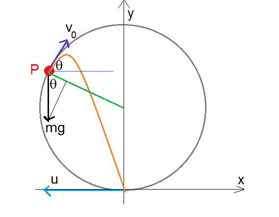

You almost solved the problem by yourself, and in case you had made a drawing and explained the notations correctly, you would have done.
You have the set-up, as in the figure. The ball starts from the origin, with speed u. It moves along the circle of radius R, till the radial component of gravity is less than the centripetal force, and some inward force is needed from the track. When the normal force is zero, the ball leaves the track and moves like a projectile along the orange line.
You said that you assumed that the ball left at angle theta with the horizontal from the circle, but worked with the angle the velocity made with the vertical. You can determine the coordinates in terms of that angIe.
The ball left the track at point P(x0,y0) with velocity V0, tangent to the circle. It encloses the angle θ with the horizontal in the figure.
You have determined the speed when the ball left the track by equating the centripetal force by the normal component of gravity but you calculated as if θ was the angle the velocity enclosed with the vertical.
You also used conservation of energy to get the relation between u and Vo: 1/2(u2-V02)=gy0
Leaving the track at P, the ball performs projectile motion. In Post #13 you wrote the x and y coordinates of the projectile but you have forgotten that x0 and y0 were the coordinates of P, the initial point of the projectile. That was your idea to solve the problem and it was correct.
The ball returns to the origin, x=0, y=0. From the equation of motion, x-x0=V0xt, y-y0=V0yt-g/2 t2, you know x and y, and you can express x0 and y0 with θ and R, and you know Vo in terms of g, R and θ, so you can find θ from these equations. Your equations were almost correct :)
Start again, using the angle θ shown in the figure, and do not forget the square roots.
